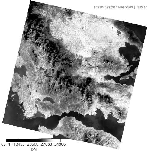

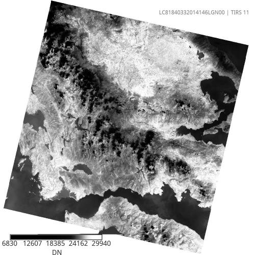

At-satellite brightness temperatures are derived from the TIRS channels 10 and 11. Prior to any processing, these are filtered for clouds and their quantized digital numbers converted to at-satellite temperature values.

Conversion of Digital Numbers to TOA Radiance. OLI and TIRS band data can be converted to TOA spectral radiance using the radiance rescaling factors provided in the metadata file:

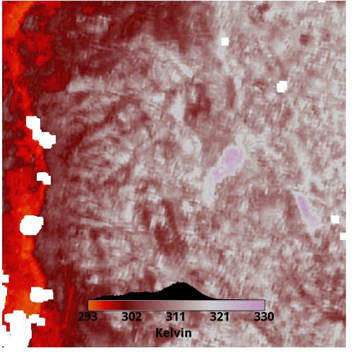

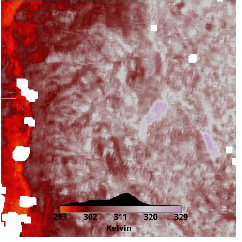

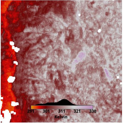

The output land surface temperature map maybe be delivered in Celsius degrees (units and appropriate color table) via the -c flag:
i.landsat8.swlst mtl=MTL prefix=B landcover=FROM_GLC -k -c
