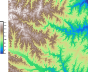

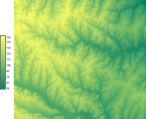

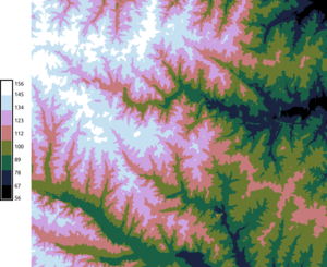

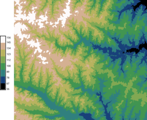

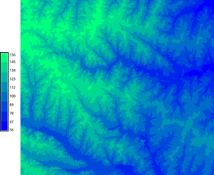

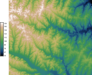

Now we set several different color tables for the elevation raster map
from the North Carolina sample dataset.
We use continuous and discrete color tables (gradients).
The color tables ae stretched to fit the raster map range.
r.colors.matplotlib color=summer map=elevation
r.colors.matplotlib color=winter ncolors=8 map=elevation -d
r.colors.matplotlib color=autumn map=elevation
r.colors.matplotlib color=cubehelix ncolors=8 map=elevation -d
r.colors.matplotlib color=terrain map=elevation
We can display legend:
d.legend raster=elevation labelnum=10 at=5,50,7,10
summer, winter, autumn, cubehelix, and terrain color tables applied
to elevation raster from the North Carolina sample dataset. winter and
cubehelix are set to be discrete instead of continuous.

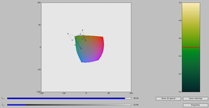

A
viscm tool is a
little tool for analyzing color tables and creating new color tables
(color maps) for Matplotlib. The tool was used to create perceptually
uniform color tables for Matplotlib (for example viridis). The new
color table is stored into a file. In version 0.7, a temporary file
named
/tmp/new_cm.py which is a Python source code which
creates a
Colormap object. If this module gets a name of
existing file instead of a color table name, it assumes that it this
kind of file and reads object called
test_cm as Matplotlib
color table. The possible workflow follows. (Note that you need to
install the viscm tool, e.g. using
sudo pip install viscm on
Linux.)
Start the tool, create and save a color table:
Now store the color table in GRASS GIS format:
r.colors.matplotlib color=/tmp/new_cm.py rules=from_viscm.txt

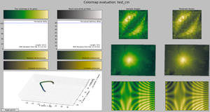

Editing color table in viscm (right): the yellow dot on the blue spline must
stay in the colored area as the red line moves. Reviewing color table
properties is done using several displays including color blindness
simulations.

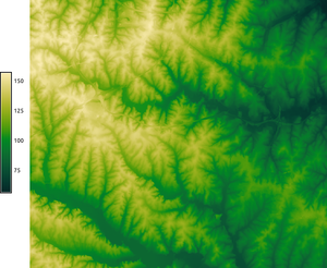

A color table from viscm applied to elevation raster
The same works for any Python files which follow the same schema,
so it works for example with files from the
BIDS/colormap repository.
