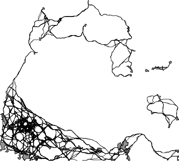

Patch vector map example
Figure: Patch vector map as input to r.connectivity.distance, produced in the example above.

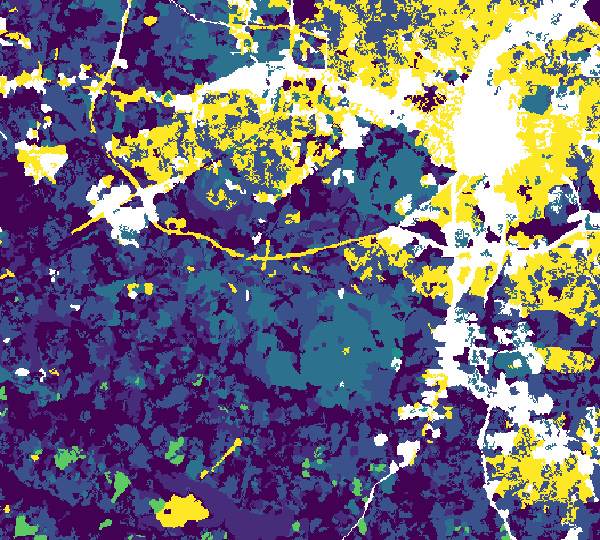

Create a cost raster:
(see also: r.cost)
For the cost raster, we assume that areas which are developed with high intensity are absolute barriers for our species (not crossable at all).
Other developed and managed areas can be crossed, but only at high costs (they are avoided where possible). Other Hardwood landcover types offer best opportunity for the dispersal of our species (they are preferred), while the costs for crossing the other landcover types is somewhere in between.
Hint: One might also add infrastructure like e.g. roads
# Reclassify land use map
# Windows users may have to use the GUI version of r.reclass
# and paste the rules there...
echo '0 = 56 #not classified (2*resolution (28m))
1 = NULL #High Intensity Developed (absolute barrier)
2 = 140 #Low Intensity Developed (5*resolution (28m))
3 = 112 #Cultivated (4*resolution (28m))
4 = 70 #Managed Herbaceous Cover (2,5*resolution (28m))
6 = 28 #Riverine/Estuarine Herbaceous (1*resolution (28m))
7 = 42 #Evergreen Shrubland (1,5*resolution (28m))
8 = 42 #Deciduous Shrubland (1,5*resolution (28m))
9 = 42 #Mixed Shrubland (1,5*resolution (28m))
10 = 28 #Mixed Hardwoods (1*resolution (28m))
11 = 28 #Bottomland Hardwoods/Hardwood Swamps (1*resolution (28m))
15 = 56 #Southern Yellow Pine (2*resolution (28m))
18 = 28 #Mixed Hardwoods/Conifers (1*resolution (28m))
20 = 42 #Water Bodies (1,5*resolution (28m))
21 = 84 #Unconsolidated Sediment (3*resolution (28m))' | r.reclass \
input=landuse96_28m output=costs rules=- --overwrite
Cost raster map example
Figure: Cost raster as input to r.connectivity.distance, produced in the example above.

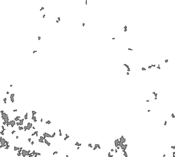

Output network represented by shortest paths
Figure: Network produced with r.connectivity.distance, visually represented by shortest paths and patch areas, produced in the example above.

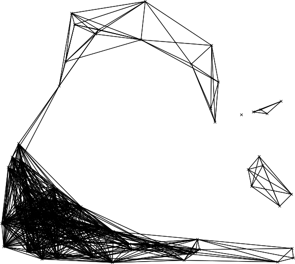

Output network visualised as a simplified (straight) network
Figure: Network produced with r.connectivity.distance, simplified visualisation with straight lines, produced in the example above.
