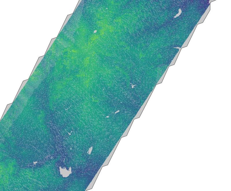

Optionally r.in.pdal creates an estimated vector footprint area map
of the LAS file when using the footprint parameter (the footprint is
generated by PDAL).

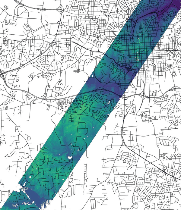

# check metadata
pdal info --summary lidar_raleigh_nc_spm_height_feet.las
# scan extent and exit
r.in.pdal input=lidar_raleigh_nc_spm_height_feet.las output=lidar_raleigh -s
# scan extent (g.region style) and exit
r.in.pdal input=lidar_raleigh_nc_spm_height_feet.las output=lidar_raleigh -s -g
# n=228500 s=215000.01 w=633370.82 e=645000 t=558.87 b=88.5
# set computation region to this extent
g.region n=228500 s=215000.01 w=633370.82 e=645000 -p
# import while aligning pixel geometry to existing "elevation" 10m res. raster map
# specifying EPSG manually because SRS information is missing in this LAS file
r.in.pdal input=lidar_raleigh_nc_spm_height_feet.las raster_reference=elevation \
          resolution=10 output=lidar_raleigh method=mean
# optionally: footprint=lidar_raleigh_footprint
# visualize
d.mon wx0
g.list vector
d.rast lidar_raleigh
d.vect streets_wake
# analyse differences between DEM and rasterized point cloud
# LAS files come with height in US feet units
r.mapcalc "diff = elevation - lidar_raleigh * 0.3048006096012192"
r.univar -e diff
Figure: View showing the difference of the elevation map and LiDAR point data binned to raster map with r.in.pdal
Figure: LiDAR cloud footprint
