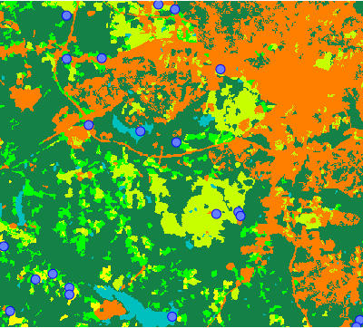

Generate three points at random location for each category (class)
in the raster map:
g.region raster=landclass96
r.sample.category input=landclass96 output=landclass_points npoints=3
Show the result:
d.rast map=landclass96
d.vect map=landclass_points icon=basic/circle fill_color=aqua color=blue size=10
Figure: Three random points in each category of landclass raster map
