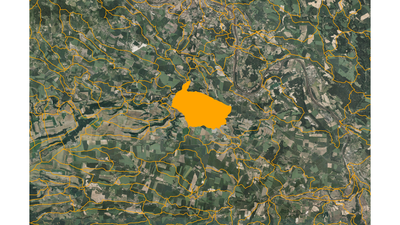

Figure: Basins (in orange) with orthophoto  on background |

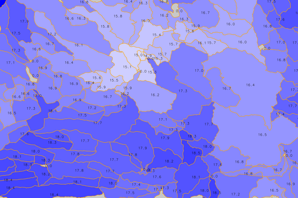

Figure: IV.order basins colored by mean H_N2T60 value (in millimeters)
r.subdayprecip.design map=basin return_period=N2,N5,N10,N20 rainlength=60
