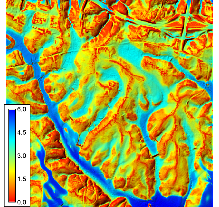

Here we are going to use the GRASS GIS sample North Carolina data set as a basis to calculate the MRVBF index.
  # align region to DEM
  g.region -a raster=el_D782_6m
  # run r.valley.bottom
  r.valley.bottom elevation=el_D782_6m mrvbf=mrvbf_el_D782_6m t_slope=40 p_slope=3 p_pctl=2
  # set colors
  r.colors map=mrvbf_el_D782_6m color=bcyr -n
  # display over a shaded relief map
  r.relief input=el_D782_6m output=hs_D782_6m altitude=45 azimuth=315 zscale=4 scale=1
  r.shade shade=hs_D782_6m color=mrvbf_el_D782_6m output=mrvbf_shade
  d.rast map=mrvbf_shade
