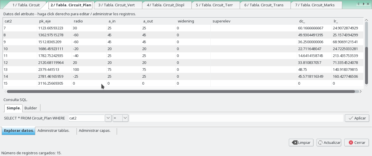

"NameRoad"_Plan, for insert the parameters of the horizontal alignment. This layer have all vertices and nodes of the horizontal polygon. No more points can be added to this layer with the insert point option.
The columns are:
+ for clockwise
- for anticlockwise

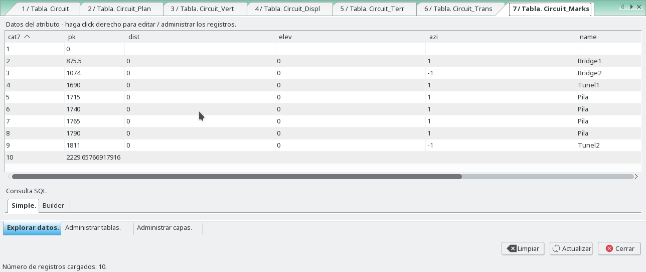

"NameRoad"_Marks, for insert the parameters of Marks. This layer are created with the first an last vertex of the horizontal polygon. New point can be added by the flag 'e' TableTools option, or with edit gui. The added points, are inserted in the central axis referencing by pk.
The columns for editing by the user are:

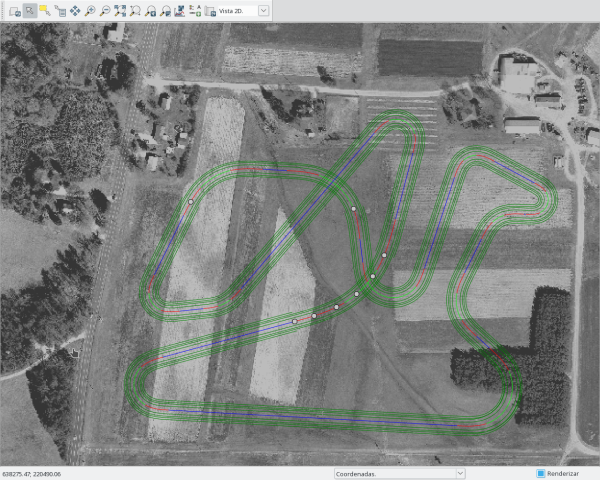

This example is done in the North Carolina data set.
At the end of this example, there is a backup that can be executed to play with this example.

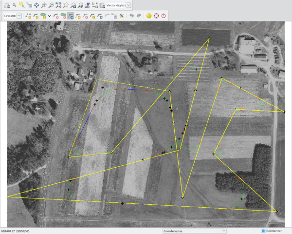

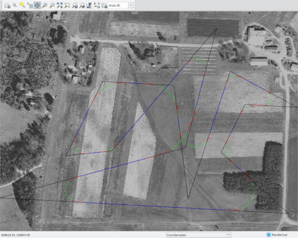

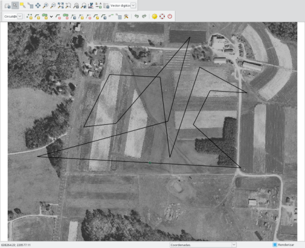

The example start creating a closed polygon with the editor, in a created map named Circuit.

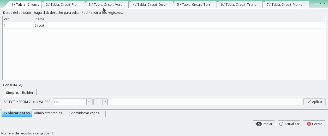

After that, run the next command to get all tables in the map Circuit

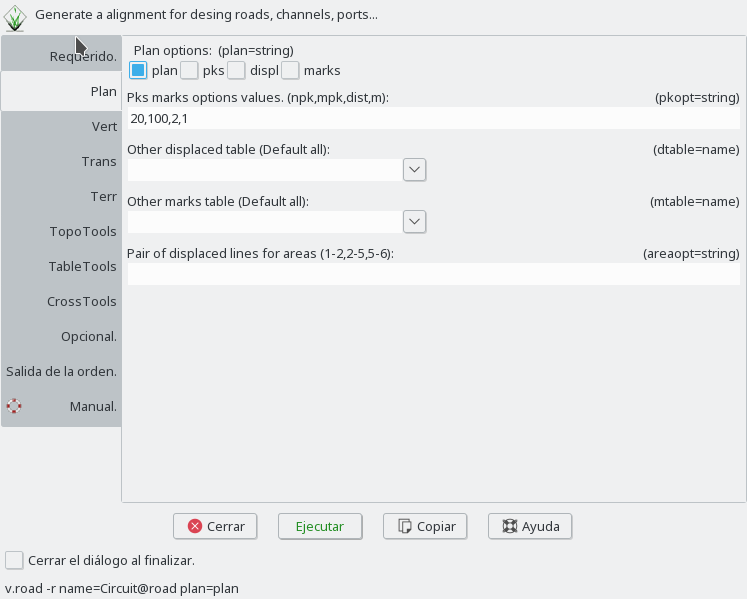

v.road -r name=Circuit

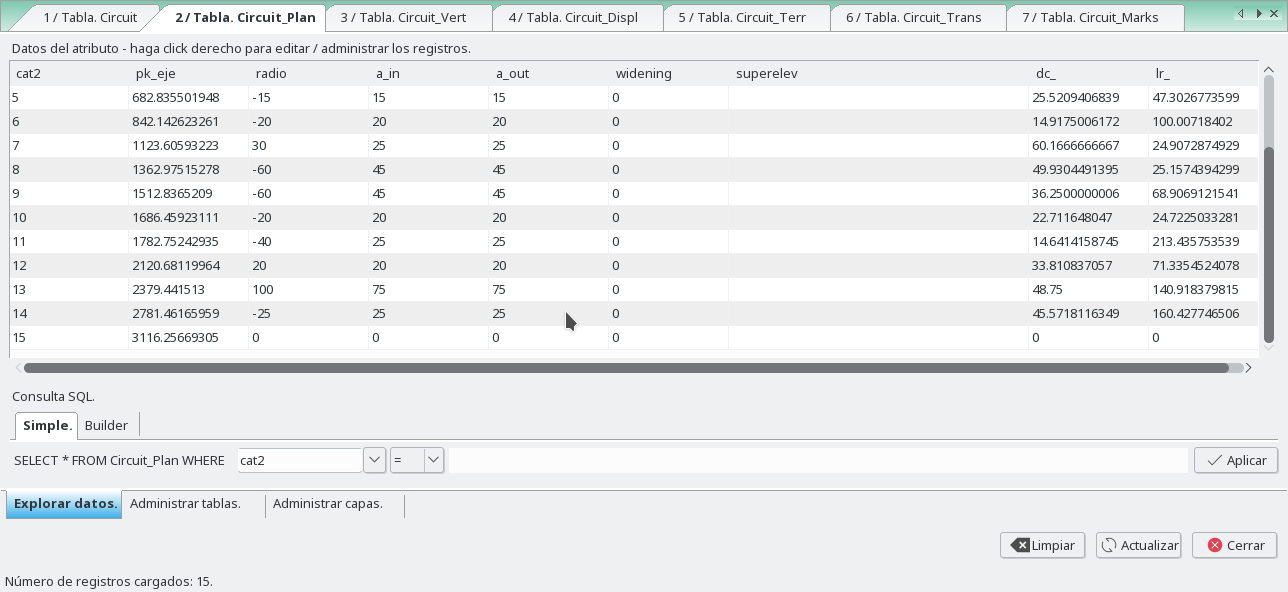

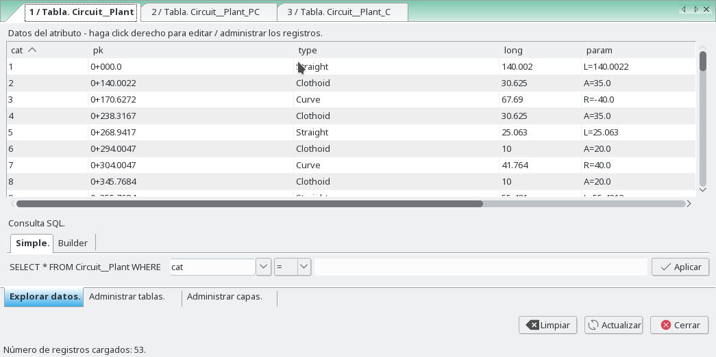

For each vertex of the polygon we define a radio and in and out clothoids. So we can write the plant and pks maps.
v.road -r name=Circuit plan=plan,pks
And we obtain the map Circuit__Plant and Circuit__Pks, and their tables.
If we move some vertex of polygon we must run with the flag 'p' to update the road.
If we change some values of columns 'dc_' (long of circle) or 'lr_' (long of straight), or fill the last line (with 'dc_' and 'lr_' too, a new vertex are inserted and a new line) we must run with the flag 't' to update the road.

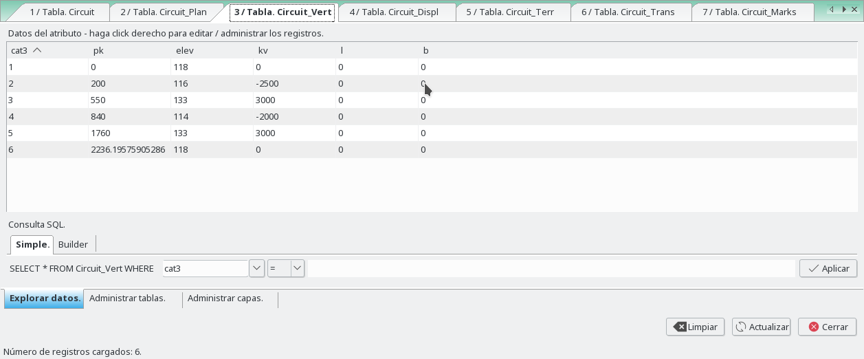

And now we have to set the elevation of those vertices and the kv parameter.

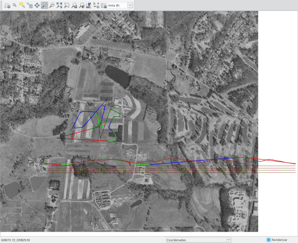

Now choose vertical option to get the vertical map in horizontal and the longitudinal profile, and give a DEM in the terrain option.
v.road -r name=Circuit vert=vert,profile dem=elev_lid792_1m
And we obtain the map Circuit__Vertical and Circuit__LongProfile , and their tables.
For first time, this table have two rows, who are the nodes of the polygon, and for that the first and the last points of the central axis.

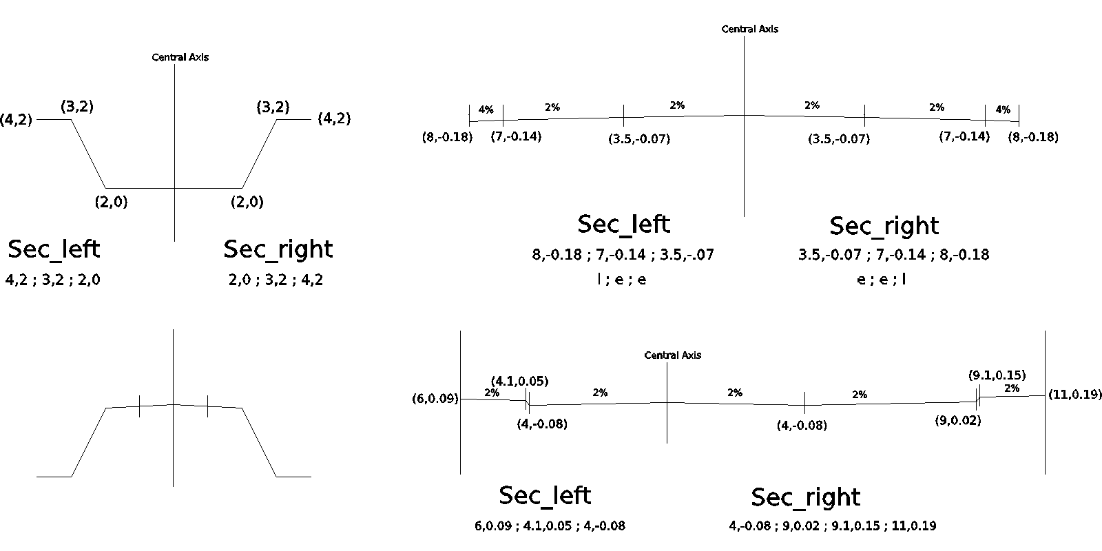

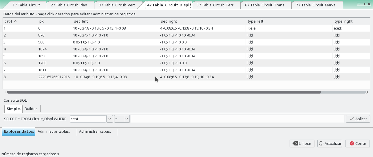

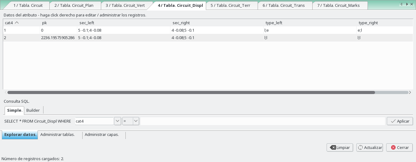

The displaced lines are defined in sec_left,sec_right columns with a list separated with ";", starting from left to right in each side of the central axis. Each displaced line is defined with distance to the central axis and height to the central axis (d,h).
The mode to calculate the displaced lines is defined in the type_left,type_right columns,for each line separated by ";".
To get more vertices we have to add new rows to this table with tabletools giving the pk of the vertex.
In this example we are going to define two displaced lines in the left side to the central axis and two for right side with slope 2% to out.
The platform lines define, the lanes of a road, the platform limits, ... Those lines can be parallel to the central axis of a road (or not). If it's so, we need to know that the parallel to a clothoid is not a clothoid. Then we have two ways to do the platform lines.
In the first way, mode exact "e", we need to calculate a new displaced central axis, e.i., a parallel to the polygon not to the central axis. The new alignment or displaced line created within the new polygon have new clothoids for the transitions. To run this mode, the first and the last points, of a section of the road, must have the same displaced distance.
The widening parameter of the section above, only will be calculate in this mode, because the widening growing in the clothoid, then is applied only to the displaced lines calculated with clothoid.
The second way, mode lineal "l", we calculate the perpendicular displaced distance to each point of the central axis, to obtain a parallel to it, where the transitions won't be clothoids. Then we can't know where are the tangents of transitions. But in this mode, the displaced distance for the first and the last points don't have to be the same in a section of the road. A lineal variation will be done between those points.
For this example, the first and last are defined as lineal and the rest are in mode exact.
Into this second way, the variation don't have to be only lineal. We can define a circumference in the displaced line with the option "rR,A".
Between two points, if the second input distance equal zero, the line will be stopped. If the second input distance equal -1, this point will not be processed and the next one will be considered.

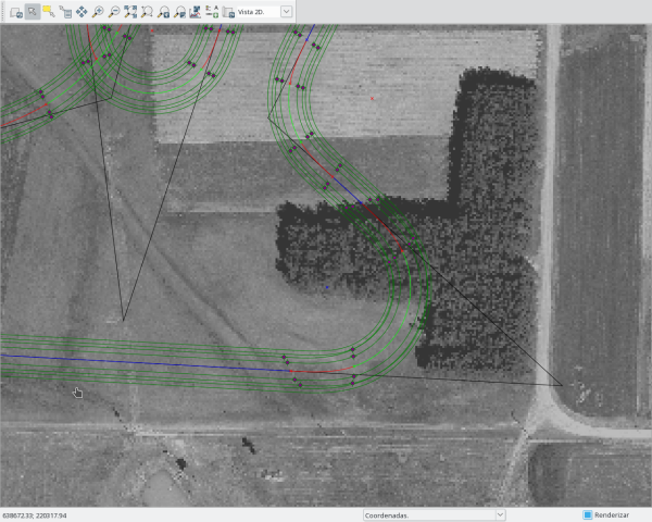

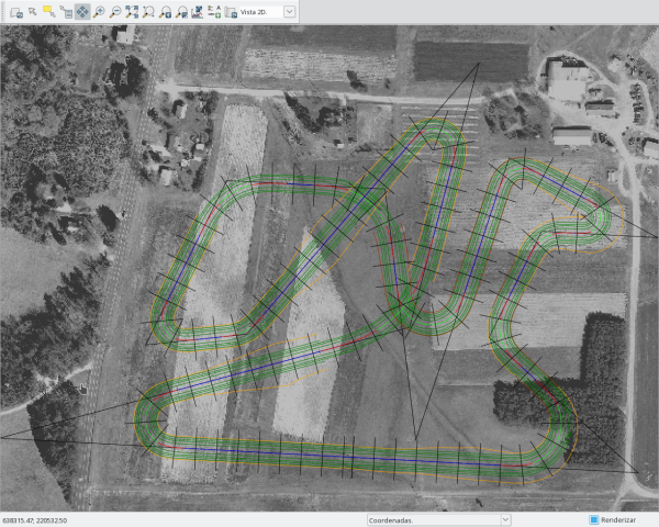

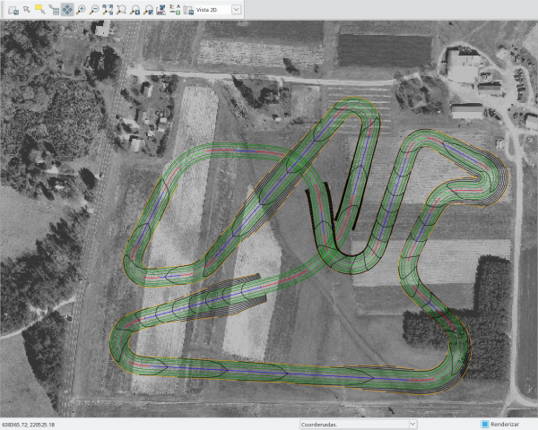

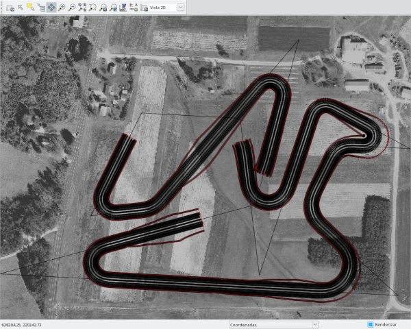

v.road -r name=Circuit plan=displ
And we obtain the map Circuit__Displaced, and their tables.
With distance to the central axis and height of the lines we can obtain different forms, that we'll see in the cross sections.
Now we can add new lines by hand or with TableTools option.
v.road -e name=Circuit displline=add side=left ncol=3 sedist="10 -0.2; 10 -0.2"
v.road -e name=Circuit displline=add side=right ncol=3 sedist="10 -0.2; 10 -0.2"
And add new points. We are going to cut the last line in pk 900 and 1700.

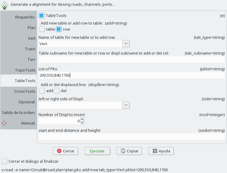

v.road -e name=Circuit@road add=row tab_type=Displ pklist=876,900,1074,1690,1700,1811
Mode exact "e" in the first two lines, without widening and with widening set to 0.2.

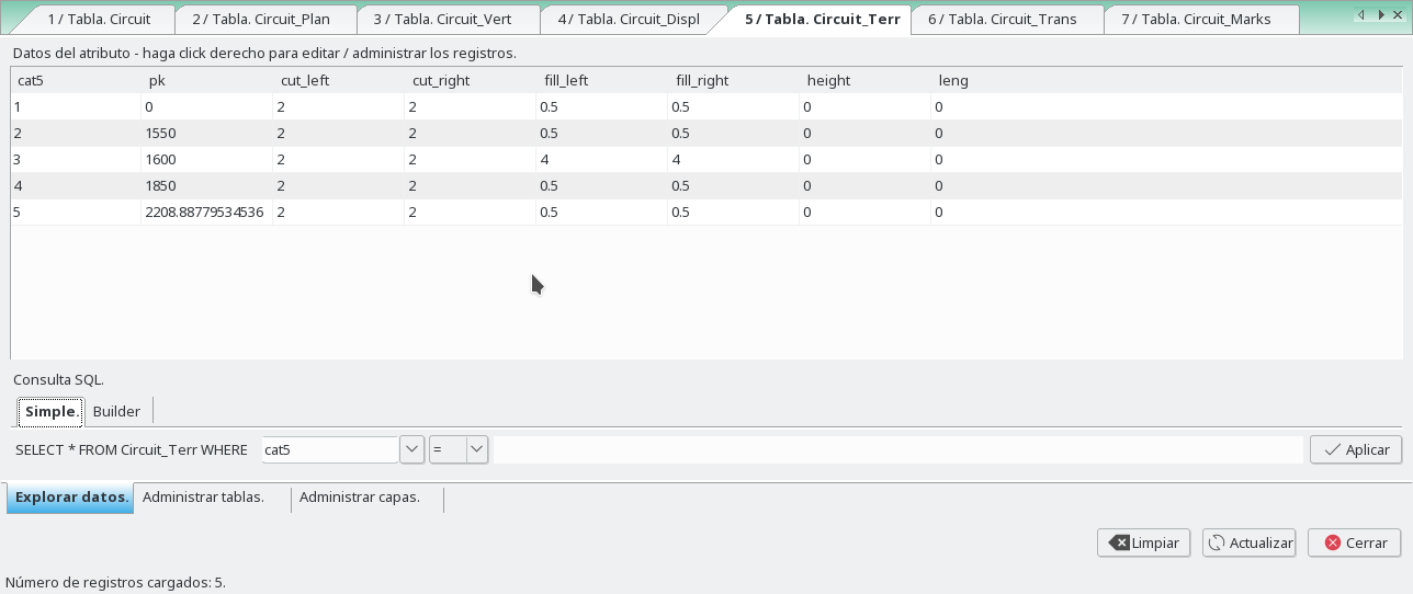

The cut/fill are calculated with the first displaced line of the left side and the last displaced line of the right side, and with the slope given in the columns cut_left, cut_right, fill_left, fill_right.
We can generate points of the different alignments, breaklines and a hull of all points.
v.road -r name=Circuit terr=slopes,sareas,topo dem=elev_lid792_1m
And we obtain the map Circuit__Slopes, Circuit__Slopes_Areas, Circuit__Topo and Circuit__Topo_Hull, and their tables.

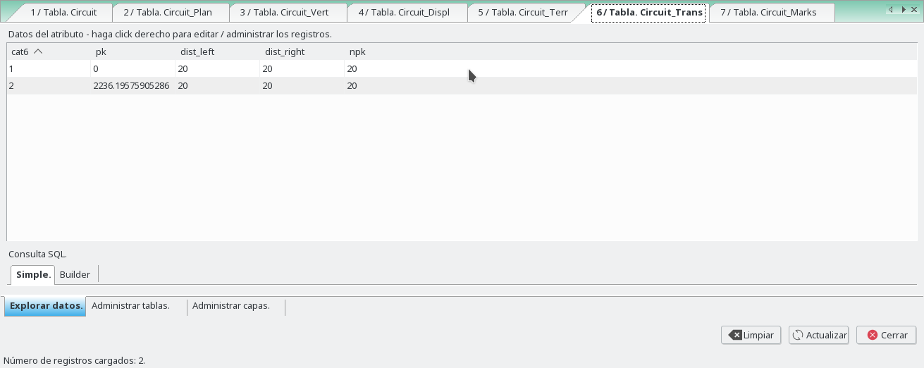

In this table where we are going to define transversals 2D lines to the central axis, to obtain later, the cross sections.
This lines contains the cutoff with the displaced lines.
When this table is created, have two rows, who are the first and the last points of the central axis.
In the columns dist_left, dist_right we can define the distance left and right to the central axis and in the column npk the distance between lines.

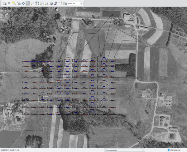

We can obtain the transversal profiles selecting it too.
v.road -r name=Circuit trans=trans,profiles dem=elev_lid792_1m
And we obtain the map Circuit__Trans and Circuit__TransProfiles, and their tables.

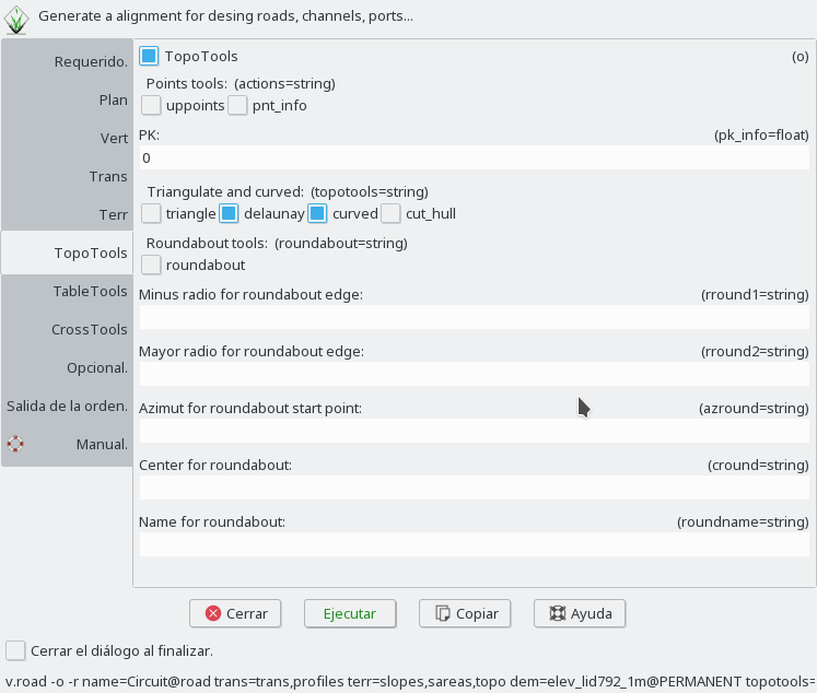

With the Circuit_Topo map created, we can triangulate with triangle or delaunay, and obtain the curves.
In this example we must delete the points that cross the road, for a good triangulation. We can run this.
v.edit map=Circuit__Topo type=point tool=delete ids=0-999999 where="pk > 876 AND pk < 1074"
v.edit map=Circuit__Topo type=point tool=delete ids=0-999999 where="pk > 1690 AND pk < 1811"
db.execute sql="DELETE FROM Circuit__Topo WHERE pk > 876 and pk < 1074"
db.execute sql="DELETE FROM Circuit__Topo WHERE pk > 1690 and pk < 1811"
And obtain the Circuit__Topo like this. The hull must be changed too.
v.road -o name=Circuit dem=elev_lid792_1m topotools=delaunay,curved,cut_hull
And we obtain the map Circuit__Topo_Tin and Circuit__Topo_Curves, and their tables.

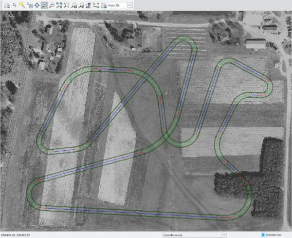

v.road -r name=Circuit plan=plan,pks,displ,marks vert=vert,profile trans=trans,profiles terr=slopes,sareas,topo dem=elev_lid792_1m
