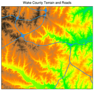

# this ps.map example draws a map of Wake county, NC raster elevation vlines roadsmajor color 30:144:255 width 2 end text 50% 105% Wake County Terrain and Roads size 550 end end
ps.map input=simple_map.txt output=simple_map.ps
Figure: Result of for the a simple Wake county terrain and roads example

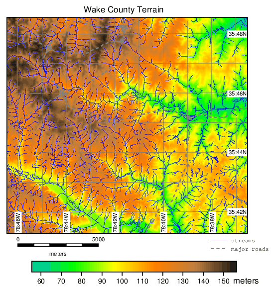

# this ps.map example draws a map of Wake county, NC raster elevation colortable y where 1 6.0 cols 4 width 4 font Helvetica end setcolor 6,8,9 white setcolor 10 green vlines streams width 0.1 color blue masked n label streams end vlines roadsmajor width 1.5 style 1111 color grey masked n label major roads end vlegend where 4.5 0 font Courier fontsize 8 end text 30% 100% Wake County Terrain color black width 1 background white size 550 ref lower left end text 92% -25% meters color black width 1 background white size 550 ref lower left end scale 1:125000 scalebar f where 1.5 5.5 length 5000 height 0.05 segment 5 numbers 5 end geogrid 60 s color gray numbers 2 black end paper a4 end end
# First set the region g.region raster=elevation # Generate map as Postsript file ps.map input=elevation_map.txt output=elevation.ps
Figure: Result of for the more complicated Wake county, NC example
