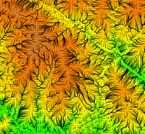

Output flowline is generated downhill. The line segments of flowline vectors have endpoints on edges of a grid formed by drawing imaginary lines through the centers of the cells in the elevation map. Flowlines are generated from each cell downhill by default; they can be generated uphill using the flag -u. A flowline stops if its next segment would reverse the direction of flow (from up to down or vice-versa), cross a barrier, or arrive at a cell with undefined elevation or aspect. Another option, skip, indicates that only the flowlines from every val-th cell are to be included in flowline. The default skip is max(1, <rows in elevation>/50, <cols in elevation>/50). A high skip usually speeds up processing time and often improves the readability of a visualization of flowline.

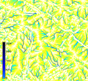

Flowline density downhill or uphill output is given in a raster map flowaccumulation. The value in each grid cell is the number of flowlines which pass through that grid cell, that means the number of flowlines from the entire map which have segment endpoints within that cell. With the -m flag less memory is used as aspect at each cell is computed on the fly. This option incurs a severe performance penalty. If this flag is given, the aspect input map (if any) will be ignored. The barrier parameter is a raster map name with non-zero values representing barriers as input.

Figure: Flow lines with underlying elevation map; flow lines with underlying flow path lengths (in map units: meters); flow accumulation map (zoomed view)
