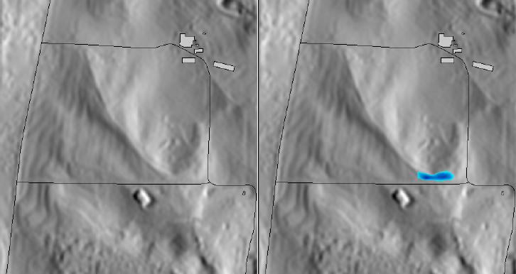

g.region raster=elev_lid792_1m -p # water accumulation next to street dam r.lake elev_lid792_1m coordinates=638759.3,220264.1 water_level=113.4 lake=flooding # draw resulting lake map over shaded terrain map r.relief input=elev_lid792_1m output=elev_lid792_1m_shade d.rast elev_lid792_1m_shade d.rast flooding d.vect streets_wake
