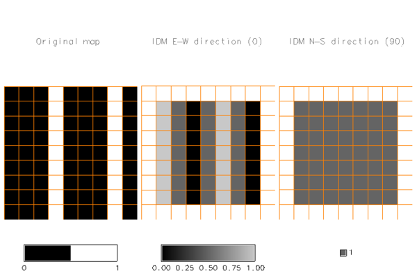

Second example: analysis of IDM (homogeneity) on a simple raster with North-South line pattern.
# import raster r.in.ascii in=- output=lines << EOF north: 9 south: 0 east: 9 west: 0 rows: 9 cols: 9 0 0 0 1 0 0 0 1 0 0 0 0 1 0 0 0 1 0 0 0 0 1 0 0 0 1 0 0 0 0 1 0 0 0 1 0 0 0 0 1 0 0 0 1 0 0 0 0 1 0 0 0 1 0 0 0 0 1 0 0 0 1 0 0 0 0 1 0 0 0 1 0 0 0 0 1 0 0 0 1 0 EOF # adjust region to raster g.region raster=lines # calculate IDM (homogeneity) in all directions r.texture -s lines method=idm output=text_lines
The following image shows the original map, the result in East-West direction and the result in North-South direction, showing how texture can depend on direction, with texture perfectly homogeneous (value=1) in the North-South direction, but quite heterogeneous in East-West direction, except for those areas where there are three columns of equal values (as size=3). The overlaid grid highlights that the texture measures output maps are cropped at the margins.
