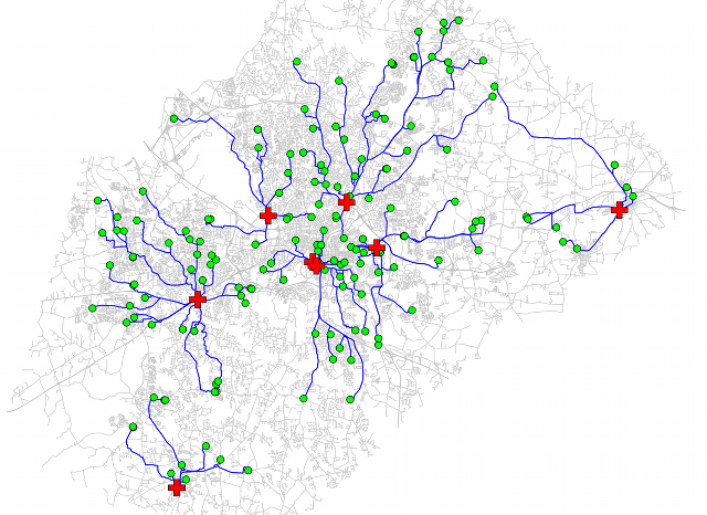

Streets are grey lines, schools are green circles, hospitals are red crosses, shortest paths are blue lines:
# connect schools to streets as layer 2
v.net input=streets_wake points=schools_wake output=streets_net1 \
      operation=connect thresh=400 arc_layer=1 node_layer=2
# connect hospitals to streets as layer 3
v.net input=streets_net1 points=hospitals output=streets_net2 \
      operation=connect thresh=400 arc_layer=1 node_layer=3
# inspect the result
v.category in=streets_net2 op=report
# shortest paths from schools (points in layer 2) to nearest hospitals (points in layer 3)
v.net.distance in=streets_net2 out=schools_to_hospitals flayer=2 to_layer=3
# visualization
g.region vector=streets_wake
d.mon wx0
d.vect streets_wake color=220:220:220
d.vect schools_wake color=green size=10
d.vect map=hospitals icon=basic/cross3 size=15 color=black fcolor=red
d.vect schools_to_hospitals
