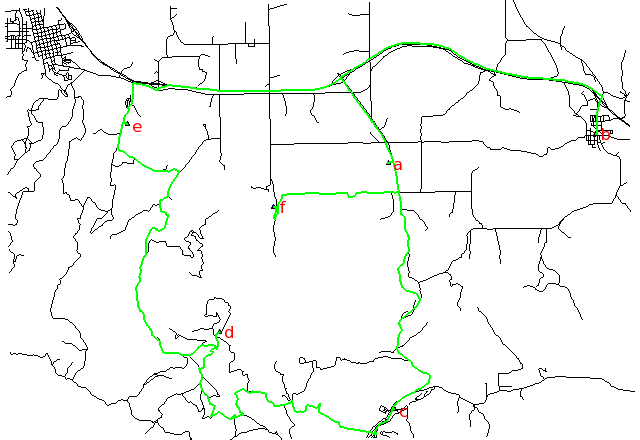

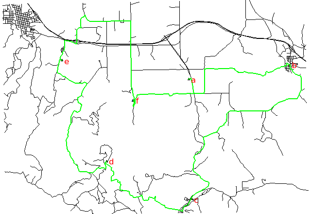

Shortest path, along unimproved roads:
Fastest path, along highways:
Searching for the shortest path using distance and the fastest path using traveling time according to the speed limits of different road types:

# find the shortest path
v.net.salesman myroads_net center_cats=1-6 out=mysalesman_distance
# set up costs as traveling time
# create unique categories for each road in layer 3
v.category in=myroads_net out=myroads_net_time opt=add cat=1 layer=3 type=line
# add new table for layer 3
v.db.addtable myroads_net_time layer=3 col="cat integer,label varchar(43),length double precision,speed double precision,cost double precision,bcost double precision"
# copy road type to layer 3
v.to.db myroads_net_time layer=3 qlayer=1 opt=query qcolumn=label columns=label
# upload road length in miles
v.to.db myroads_net_time layer=3 type=line option=length col=length unit=miles
# set speed limits in miles / hour
v.db.update myroads_net_time layer=3 col=speed val="5.0"
v.db.update myroads_net_time layer=3 col=speed val="75.0" where="label='interstate'"
v.db.update myroads_net_time layer=3 col=speed val="75.0" where="label='primary highway, hard surface'"
v.db.update myroads_net_time layer=3 col=speed val="50.0" where="label='secondary highway, hard surface'"
v.db.update myroads_net_time layer=3 col=speed val="25.0" where="label='light-duty road, improved surface'"
v.db.update myroads_net_time layer=3 col=speed val="5.0" where="label='unimproved road'"
# define traveling costs as traveling time in minutes:
# set forward costs
v.db.update myroads_net_time layer=3 col=cost val="length / speed * 60"
# set backward costs
v.db.update myroads_net_time layer=3 col=bcost val="length / speed * 60"
# find the fastest path
v.net.salesman myroads_net_time arc_layer=3 node_layer=2 arc_column=cost arc_backward_column=bcost center_cats=1-6 out=mysalesman_time
# Display the results g.region vector=myroads_net # shortest path d.mon x0 d.vect myroads_net d.vect centers -c icon=basic/triangle d.vect mysalesman_distance col=green width=2 d.font Vera d.vect centers col=red disp=attr attrcol=label lsize=12 # fastest path d.mon x1 d.vect myroads_net d.vect centers -c icon=basic/triangle d.vect mysalesman_time col=green width=2 d.font Vera d.vect centers col=red disp=attr attrcol=label lsize=12
