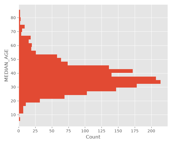

EXAMPLE
Show the histogram of median age values in the census block map:
v.histogram map=censusblk_swwake column=MEDIAN_AGE where="TOTAL_POP>0"
Histogram of median age values in census blocks
