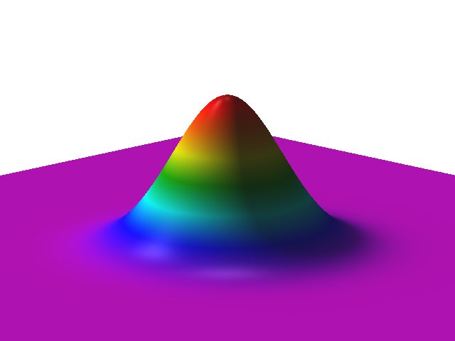

Create a simple Gaussian bell
r.surf.volcano -r output=seamount method=gaussian
# view in the display monitor
r.colors seamount color=roygbiv
d.rast seamount
# render in 3D
m.nviz.image elevation_map=seamount out=gaussian \
  perspective=10 resolution_fine=1 height=3500
# export to Matlab
r.out.mat in=seamount out=seamount.mat
# integrate into existing DEM
r.mapcalc "seamount_dem = if(seamount > dem, seamount, dem)"
r.colors seamount_dem color=srtm
image-alt Gaussian bell
