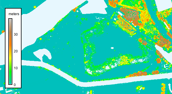

Example 3
Import the CHM based on version 4 of DTM and DSM with a resolution of 0.5 meter.
r.in.ahn product=chm output=chm_crevecoeur resolution=0.5 version=4
r.in.ahn example
Figure: CHM map of Fort Crèvecoeur
