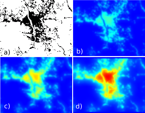

Figure: Effect of parameters size and gamma:
a) initial development,
b) gamma = 2, size = 10,
c) gamma = 1.5, size = 10,
d) gamma = 1.5, size = 20.
