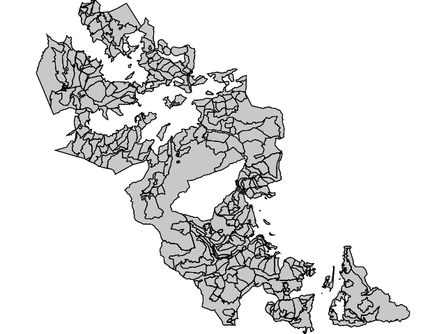

This example shows a typical input vector file with a table composed by fields of increment, forest surface, management and treatment. This example is based on data of Maè Valley, one of the test area of the R.green project
		| increment | surface | management | treatment |
		| 35.87 | 1500 | 1 | 1 |
		| 16.48 | 900 | 1 | 2 |
		| 24.82 | 500 | 2 | 1 |

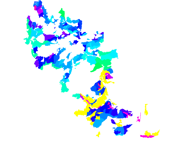

r.green.biomassfor.theoretical --overwrite forest=forest@biomasfor boundaries=Boundary@biomasfor forest_column_increment=increment forest_column_yield_surface=surface forest_column_management=management forest_column_treatment=treatment energy_tops_hs=0.49 energy_cormometric_vol_hf=1.97 energy_tops_cops=0.55 output_basename=mae
The output map is a standardize energy map with the pixel value equal to the corresponding bioenergy stimated.
