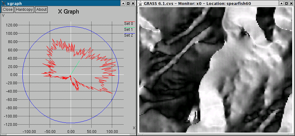

Polar diagram of aspect map
In this example, the polar diagram of the 'aspect' angle map in the
North Carolina sample dataset location is generated:
g.region raster=aspect -p
d.polar aspect
