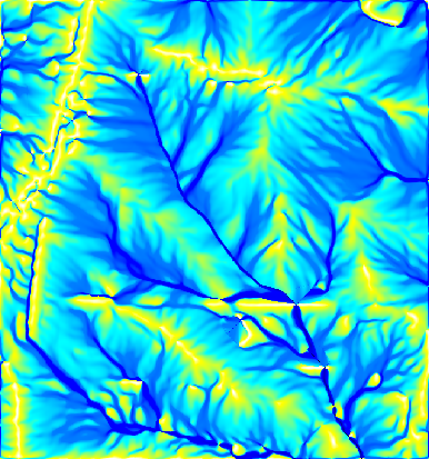

r.terraflow also computes the tci raster (topographic convergence index, defined as the logarithm of the ratio of flow accumulation and local slope).
