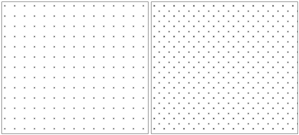

North Carolina sample dataset example, creating a 1km spaced point grid
based on the current region extent defined by the "elevation" map:
g.region raster=elevation res=1000 -pa
v.mkgrid type=point map=pointpattern
North Carolina sample dataset example, creating a regular spaced point grid
based on the current region extent defined by the "elevation" map, using
a two-step approach:
# create first set of points, covering extent of "elevation" raster map
v.mkgrid type=point map=pointpattern1
# shift grid by half point distance (map units)
g.region n=n+500 w=w+500 e=e+500 s=s+500 -p
# create second set of points
v.mkgrid type=point map=pointpattern2
# merge into final point pattern
v.patch input=pointpattern1,pointpattern2 output=pointpattern3
Different point patterns for sampling design

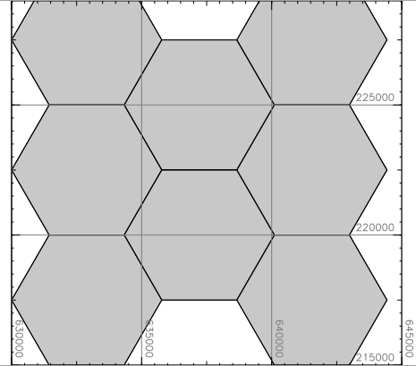

North Carolina sample dataset example, creating regular hexagons
based on the current region extent defined by the "elevation" map and
raster resolution for the hexagon size:
g.region raster=elevation res=5000 -pa
v.mkgrid map=hexagons -h
d.grid 5000
Hexagon map

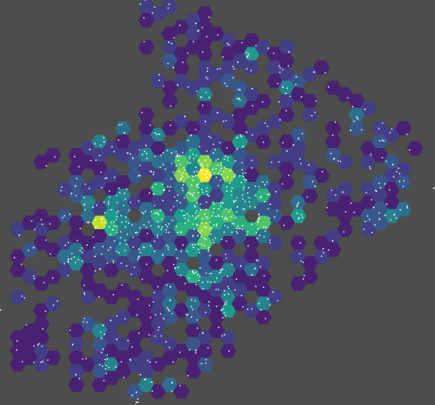

To compute point density in a hexagonal grid for the vector map
points_of_interest in the basic North Carolina sample dataset,
the vector map itself is used to set extent of the computational region.
The resolution is based on the desired size of hexagons.
g.region vector=points_of_interest res=2000 -pa
The hexagonal grid is created as a vector map based on the previously
selected extent and size of the grid.
The following counts the number of points per hexagon using the
v.vect.stats module.
v.vect.stats points=points_of_interest areas=hexagons count_column=count
User should note that some of the points may be outside the grid
since the hexagons cannot cover all the area around the edges
(the computational region extent needs to be enlarged if all points
should be considered).
The last command sets the vector map color table to
viridis
based on the
count column.
v.colors map=hexagons use=attr column=count color=viridis
Point density in a hexagonal grid
