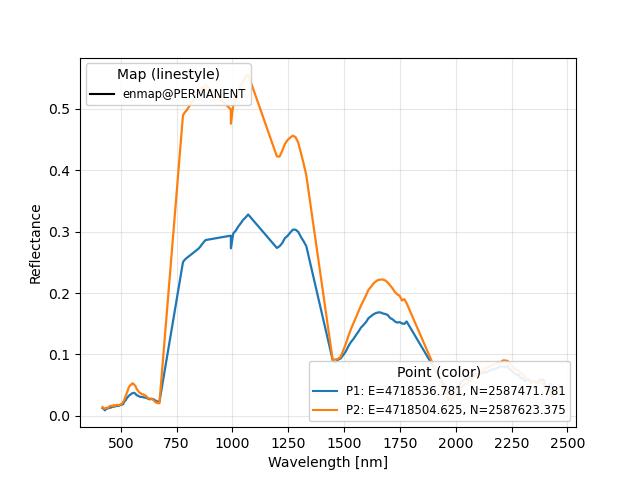

# Example 1: Compare spectra from EnMAP 3D raster map at two locations
i.hyper.explore map=enmap@PERMANENT \
coordinates=4718536.78125,2587471.78125,4718504.625,2587623.375
Figure: Reflectance spectra plots generated with i.hyper.explore
Data source: Copyright © 2012–2025 EnMAP at Earth Observation Center EOC of DLR.

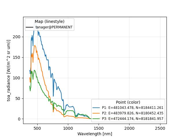

# Example 2: Explore multiple spectra from Tanager 3D raster map
i.hyper.explore map=tanager@PERMANENT \
coordinates=481043.478,8184411.261,483979.826,8180452.435,472444.174,8181841.957
Figure: Radiance spectra plots generated with i.hyper.explore
Data source: Planet Labs – Open Data, CC-BY-4.0.
