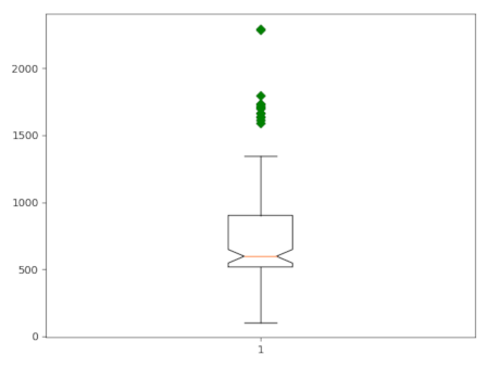

Use the vector layer
schools_wake from the
NC sample
dataset to create boxplots of the core capacity of the schools in
Wake County, North Carolina. Use the
Where clause to exclude
all records with no data.
d.vect.colbp -n map=schools_wake column=CORECAPACI where="CORECAPACI >0"
Figure 1: Boxplot of core capacity of schools in Wake County.

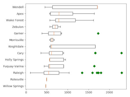

NC sample
Wake County, North Carolina, grouped by city. Use the
Where
clause to exclude all records with no data.
d.vect.colbp -h --overwrite map=schools_wake column=CORECAPACI where="CORECAPACI >0" group_by=ADDRCITY order=ascending
Figure 2" Boxplot of core capacity of schools in Wake County, grouped by city.
