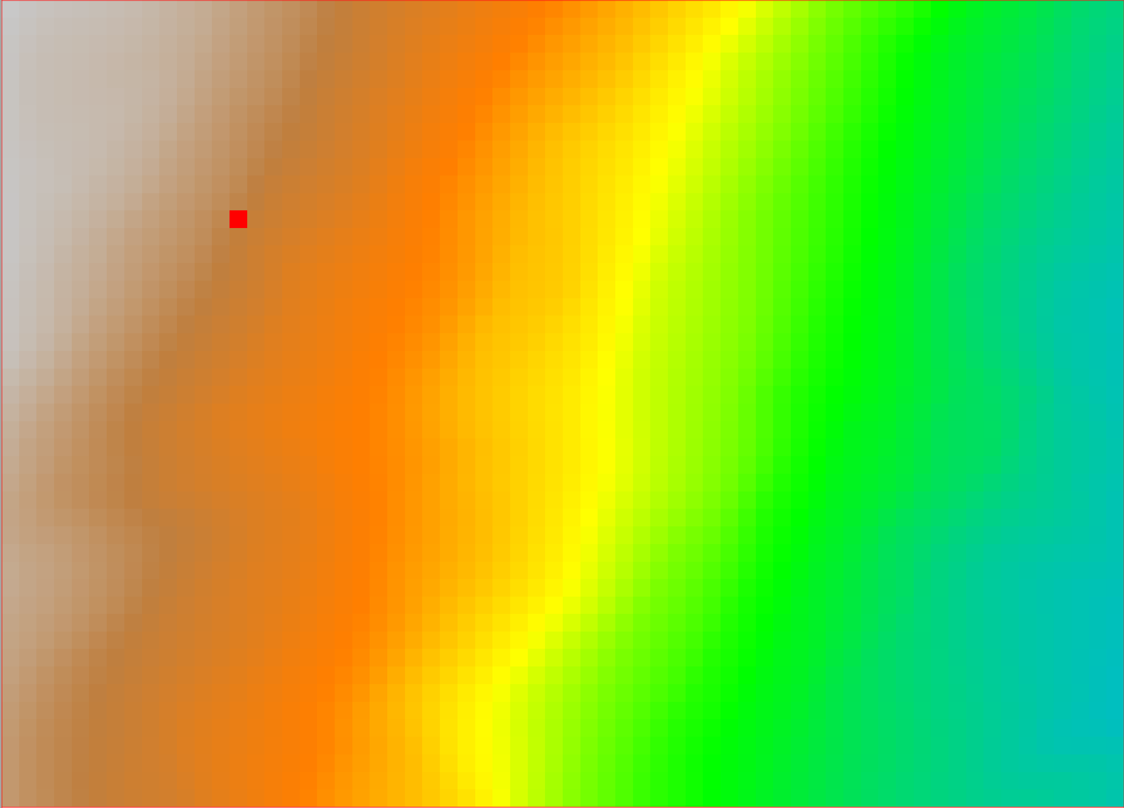

A sample portion of a 10m x 10m resolution DEM, with one grid cell (red square) acting as a rockfall source point, with raster value 100: the effect on the model r.stone is to simulate 100 trajectories starting from that cell.
r.stone output

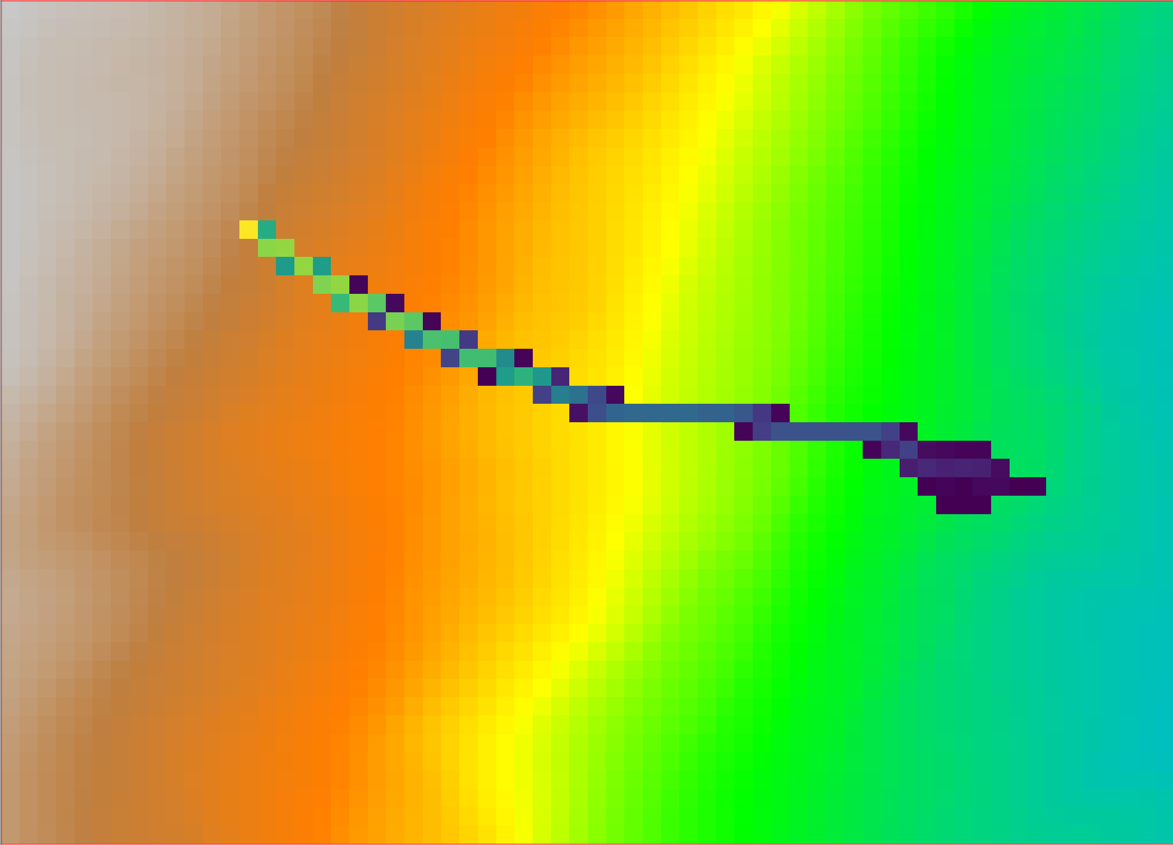

Sample output of r.stone, depicting the counter raster map; the values of the raster output correspond to the total number of simulated trajectories going through that cell.
r.stone output
