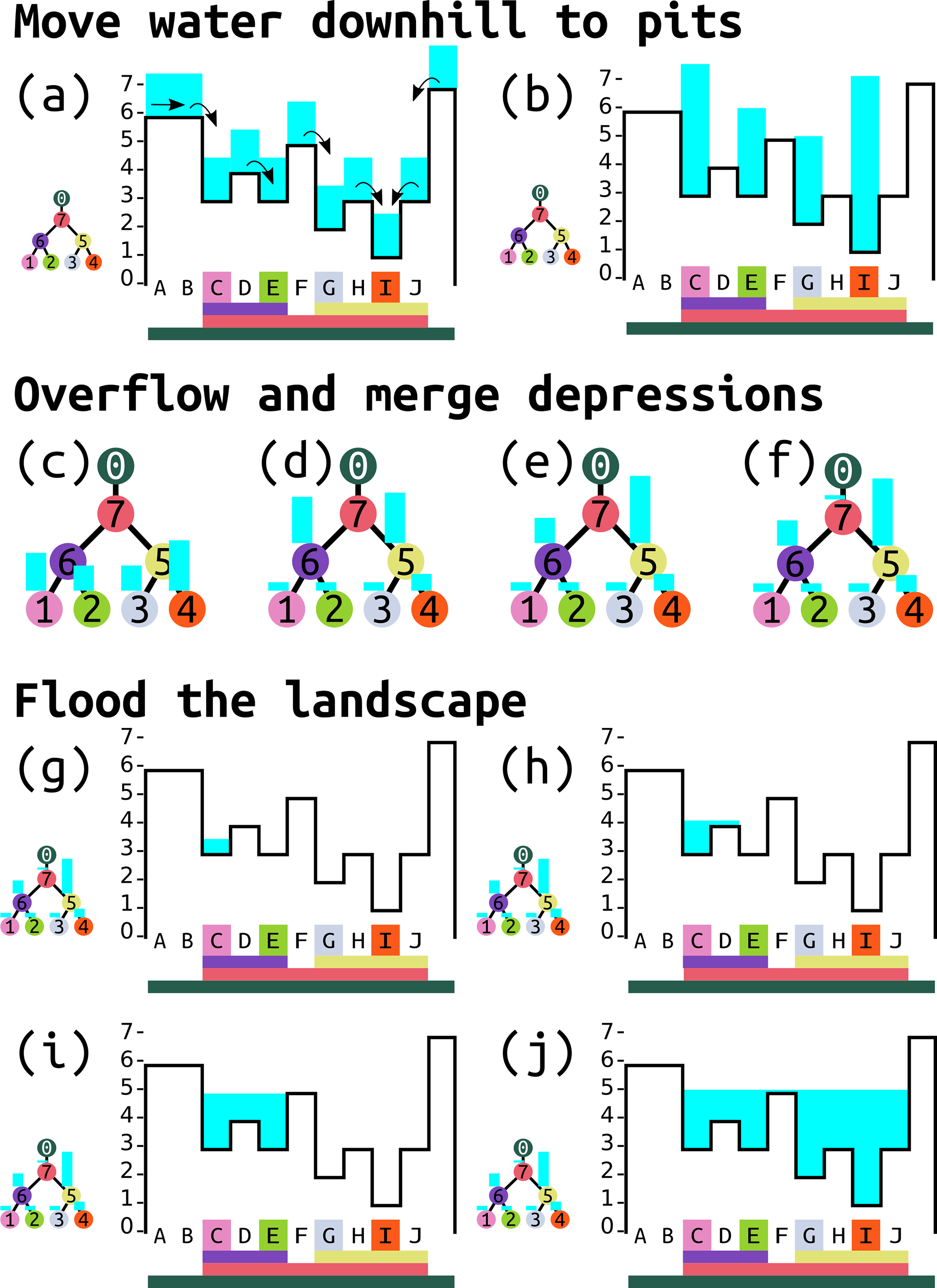

r.richdem.fsm applies the Fill--Spill--Merge algorithm (Barnes et al., 2021) to redistribute surface water across a landscape, respecting the topographic depression hierarchy computed by r.richdem.dephier. Unlike conventional flow-accumulation approaches that require depressions to be pre-filled, Fill--Spill--Merge retains real depressions and routes water through them explicitly.
The algorithm operates in three stages:
  1. Downslope routing --- surface water (positive water-table depth values) is routed downslope to pit cells using the precomputed flow directions, accumulating in the bottoms of depressions.
  2. Hierarchy traversal --- the depression hierarchy is traversed depth-first. When a depression fills to its pour-point elevation, excess water spills into the adjacent depression identified by the geolink. If both depressions are full they merge into their parent meta-depression, and water is redistributed across the combined volume. This continues until all water is accounted for or reaches the ocean.
  3. Water surface mapping --- the equilibrium water surface elevation in each depression is computed from the total water volume and the depression's hypsometry, then written back to the output raster as water-table depth.
Fill-Spill-Merge algorithm three stages The three stages of the Fill--Spill--Merge algorithm illustrated on a synthetic landscape. (a--b) Downslope routing moves surface water to pit cells. (c--f) Hierarchy traversal: depressions fill, overflow at pour points, and merge into meta-depressions. (g--j) Water surface mapping back-calculates the equilibrium water-table depth in each depression from the accumulated volume. Figure 4 from Barnes, Callaghan & Wickert (2021), CC-BY 4.0.
