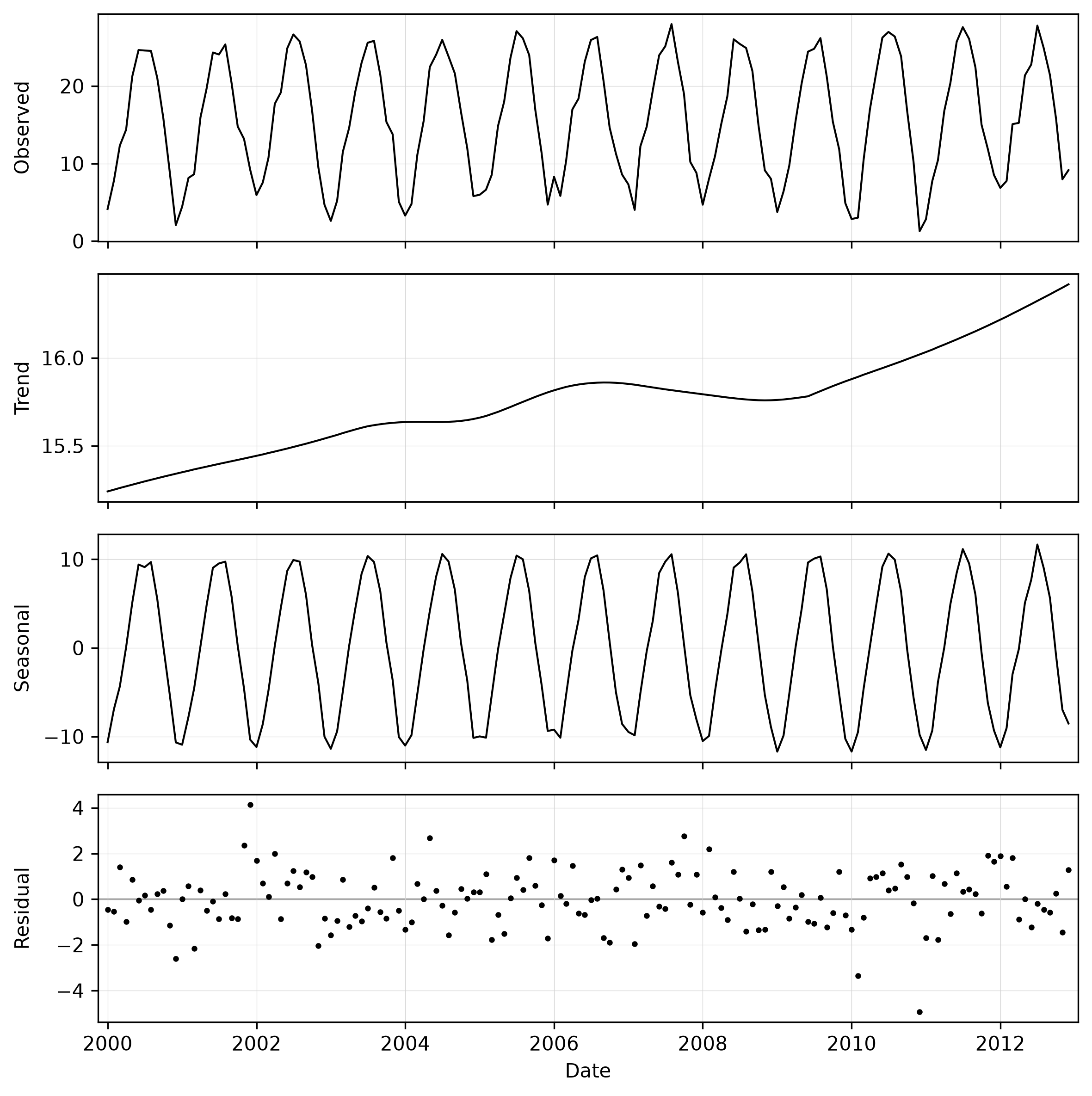

t.rast.stl extracts the time series of a single user-selected point from a space-time raster dataset (strds), runs an STL decomposition (Seasonal-Trend decomposition using LOESS) on it, and produces a multi-panel plot of the observed series together with its trend, seasonal and residual (remainder) components. Optionally, one or more trend regressions are fitted to the deseasonalized series and drawn on the trend panel: an ordinary least-squares (OLS) line, a robust Theil-Sen line, and/or a shape-constrained (monotone) Generalized Additive Model (GAM) curve.
The module is a standalone tool that works on any strds, with either absolute (calendar-dated) or relative (integer-stepped) time. Internally it uses t.rast.what to sample the pixel value at every registered timestep, regularizes the resulting irregular series onto an evenly spaced time axis (a hard requirement of STL), and then runs statsmodels.tsa.seasonal.STL.
About STL
Environmental time series derived from remote sensing, like a vegetation index, land surface temperature, snow cover, or soil moisture, are normally composed of:
  • a repeating seasonal pattern, e.g. vegetation greening up every spring and senescing every autumn;
  • a slower trend, e.g. a multi-year changes such as recovery after a disturbance, or climate change;
  • short-term residual variation that is left over once season and trend are removed. This can be noise from weather, sensor noise, residual cloud contamination, or one-off events such as a fire or a flood.
STL is a procedure that separates these three temporal patterns. It models the observed value at each date as
observed = trend + seasonal + residual
It estimates the trend and seasonal patterns by repeatedly fitting LOESS (LOcally Estimated Scatterplot Smoothing) curves. These are flexible local regressions that follow the data without assuming a fixed global functional shape. STL is robust, handles long seasonal cycles, and (in its robust variant) can down-weight outliers such as undetected clouds.
Once decomposed, each component answers a different question. The seasonal panel shows the typical within-year cycle; the trend panel shows where the system is heading once seasonality is removed and the residual panel highlights dates that depart from the expected season-plus-trend behaviour. These include normal day-to-day variation, but could also be used to flag anomalies.
The module can be run with default settings to explore patterns. The minimum input is the strds and point coordinates. If the maps in the strds are not regularly spaced, you will need to provide the required frequency as well. For more information about this parameter and other fine-tune options, see the next section.

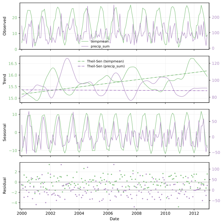

Comparing two datasets
A second space-time raster dataset can be supplied with strds2. When given, the full analysis (regularization, STL decomposition and trend regression) is run on both datasets and the two are drawn together on the same four panels (Observed, Trend, Seasonal, Residual). By default the first dataset is plotted against the left y-axis and the second against its own twin right y-axis on each panel, so two quantities with very different units or ranges (for example temperature and precipitation) can be compared on a shared time axis. The two series are distinguished by colour, with the y-axis tick numbers coloured to match and a single legend in the Observed panel naming each dataset.
The trend regression lines requested with -o, -s and -g are drawn on the Trend panel for both datasets. Each dataset's regression lines use a colour family matching its series, while the line style identifies the regression type (OLS dashed, Theil-Sen dash-dot, GAM dotted). The -t flag adds the slope/R²/p statistics to it. The full statistics for each dataset are always printed to the terminal regardless.
When the two datasets are in comparable units, the -y flag forces them onto a single common y-axis range per panel (instead of separate left/right axes), so their magnitudes can be read directly against one another. This flag has no effect unless strds2 is given.
The series line colours can be set with color (for strds) and color2 (for strds2). Each accepts a standard GRASS colour name (such as blue or aqua), an R:G:B triplet with each component in 0-255 (such as 0:0:255), hex code (#1f77b4) or a tab: name. The trend regression lines for a dataset are drawn in a darker family derived from its series colour. In the single-dataset case color sets the series colour while the OLS/Theil-Sen/GAM lines keep their default (red/green/purple).
Both datasets must share the same temporal type (both absolute or both relative). The second series is extracted at the same point and regularized with the same frequency/step and interpolation settings as the first.

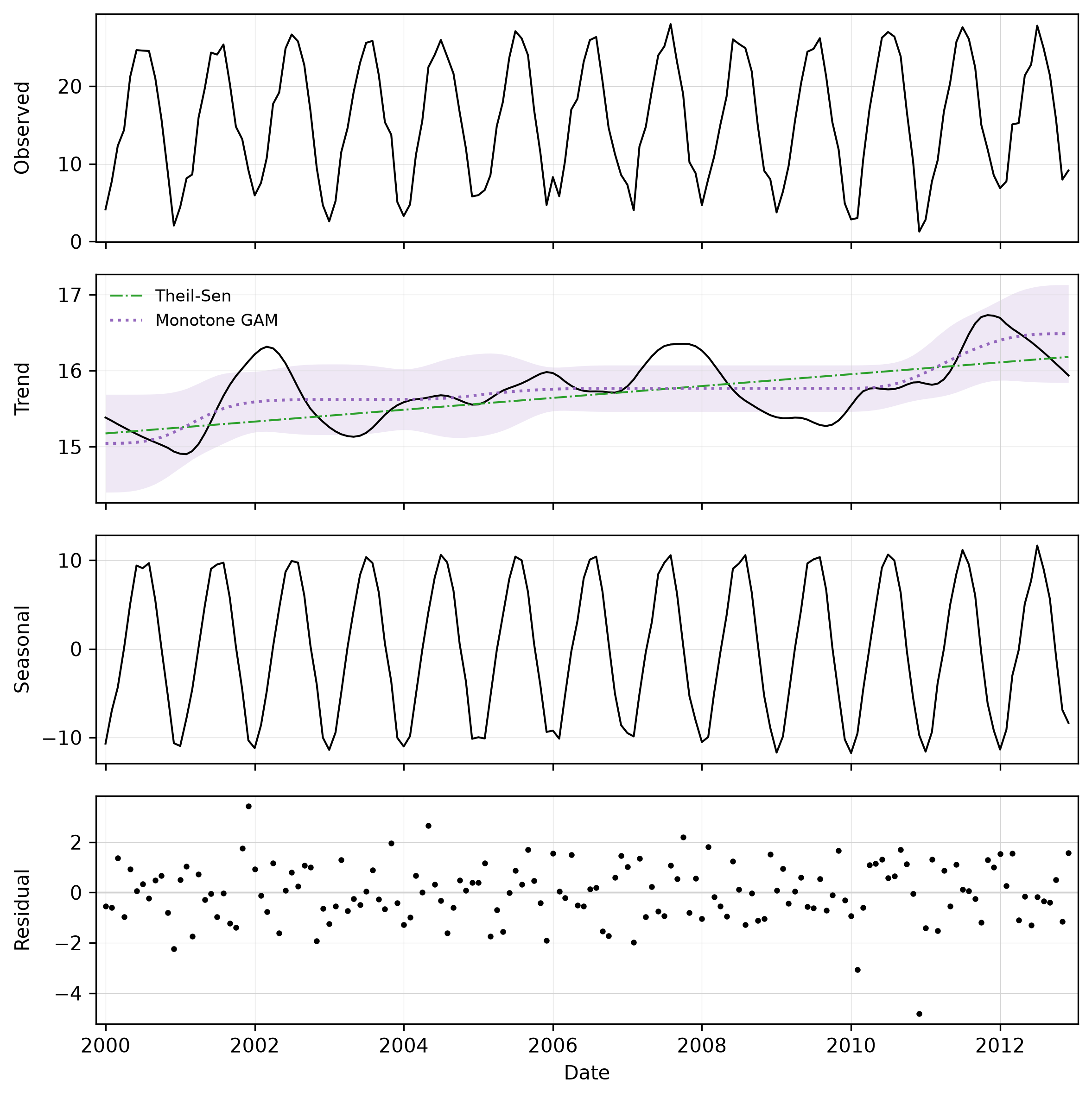

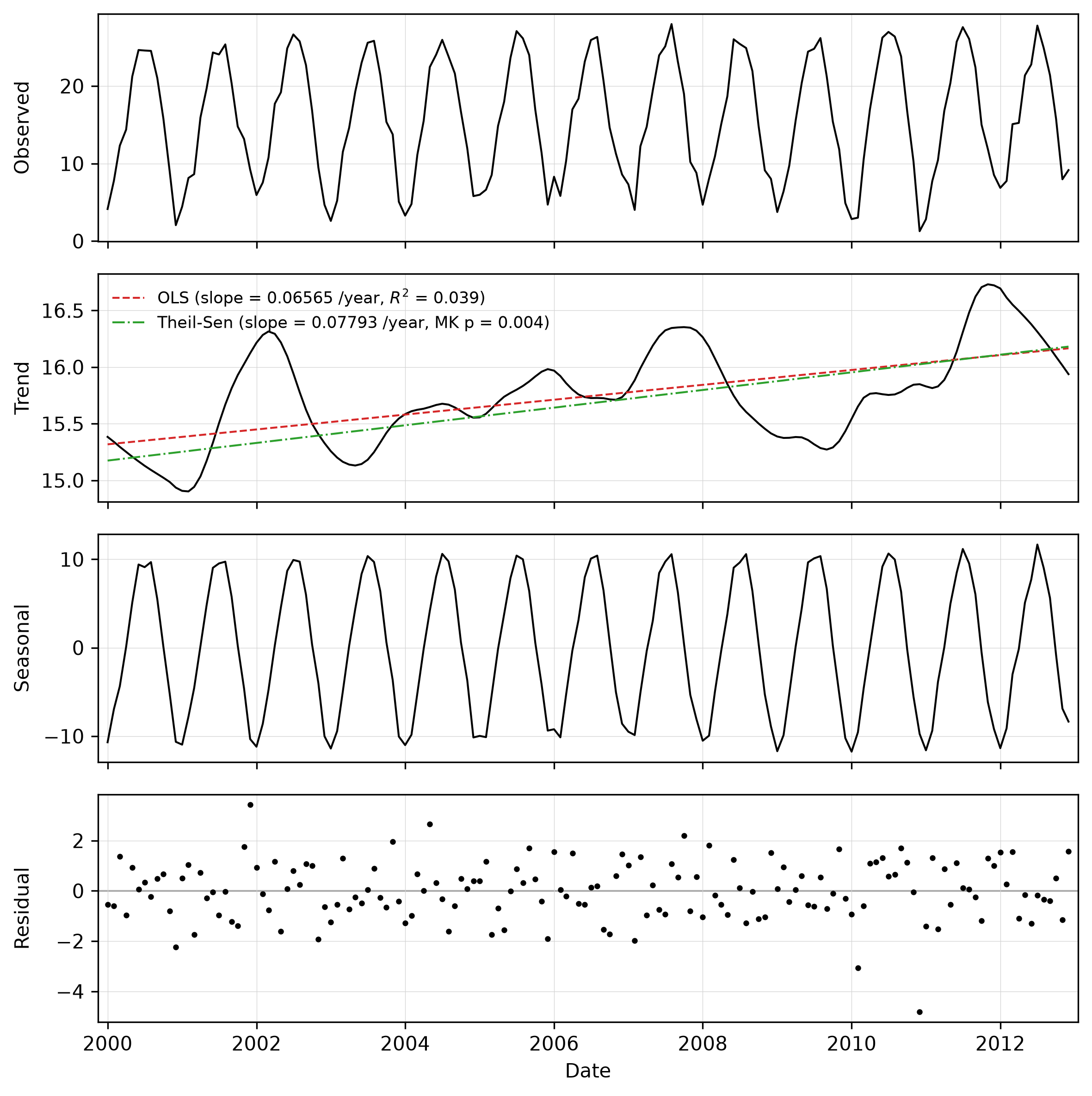

Beyond the visual decomposition, the tool quantifies the long-term change by fitting regressions to the deseasonalized observed series and drawing them on the trend panel. The deseasonalized series is trend + residual (equivalently observed - seasonal)
Three fits are available. The first is an ordinary least-squares (OLS) line, reported with its slope and . The second is a robust Theil-Sen line (SciPy's theilslopes), reported with its slope and a monotonic-trend p-value from Kendall's rank-correlation test (SciPy's kendalltau). Note that this differs from a full Mann-Kendall test, which applies tie and variance corrections. The reported p-values may therefore differ slightly when the data contain ties.
Which line(s) appear on the trend panel is controlled by flags: -o draws the OLS line, -s draws the Theil-Sen line, and -g draws a monotone GAM curve (see below). Note that the Theil-Sen slope with the non-parametric Kendall test is more resistant to outliers and does not assume normal residuals.
The -t flag adds the trend-line statistics (slope, R², Mann-Kendall p-value, and GAM net change) to the legend. The statistics are always printed to the terminal regardless of this flag.
The third fit, enabled with -g, is a shape-constrained (monotone) Generalized Additive Model fitted with pyGAM. It is a smooth, flexible curve, but constrained to never reverse direction. The gam_direction option sets the constraint direction: increasing, decreasing, or auto (the default, which picks the direction from the sign of the Theil-Sen slope). The GAM is summarised by its net change (fitted value at the last point minus the first, over the fitted span) and the explained deviance. The -b flag additionally shades the GAM's 95% confidence band.

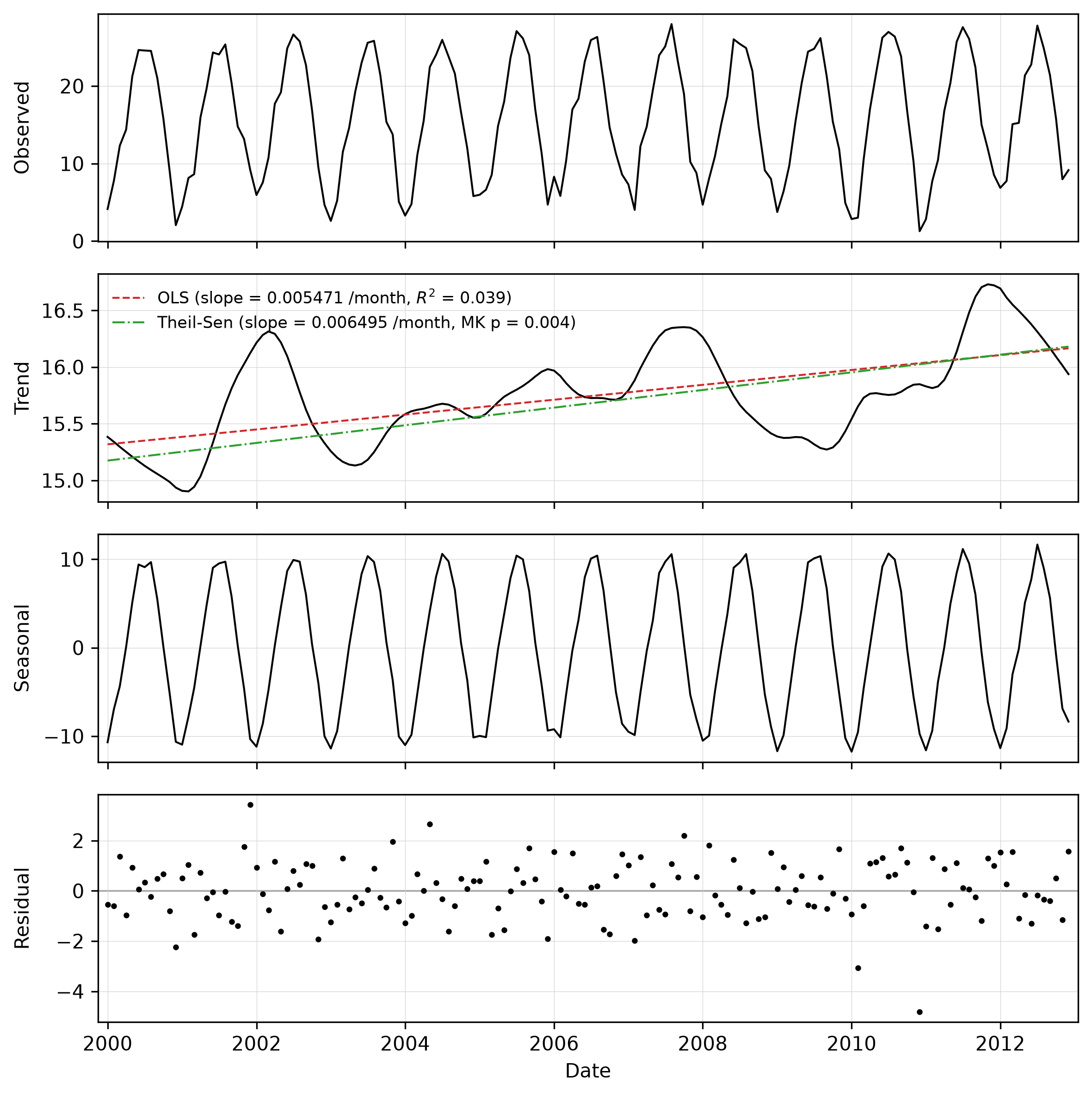

The slopes (OLS, Theil-Sen) and the GAM net change are expressed per observation of the regularized series, i.e., per step of the chosen frequency (absolute series) or step (relative series). For a daily (D) series this is per day; for a 16-day composite (16D) it is per 16-day step, for a monthly (MS) series per month, and so on.

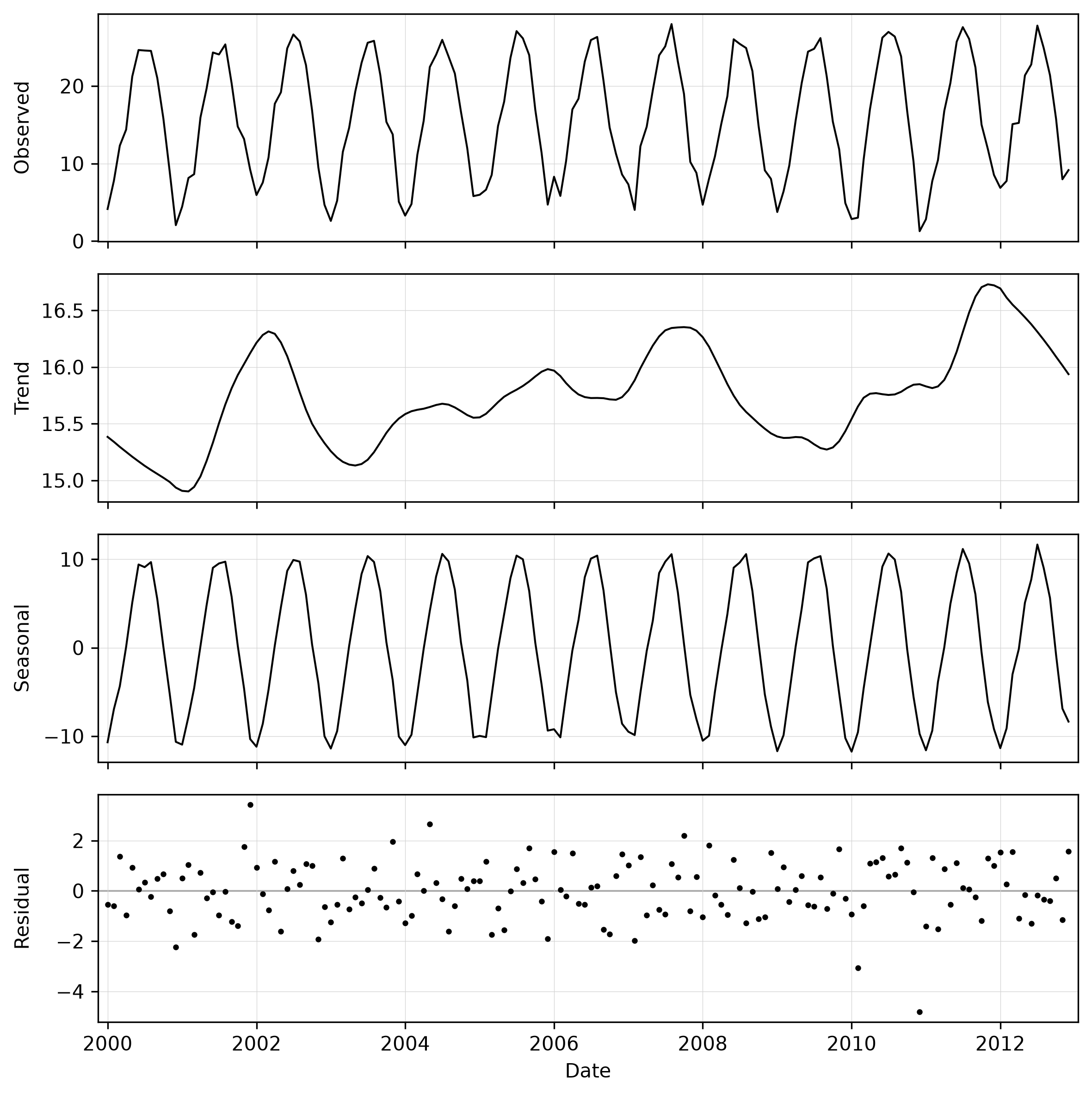

The STL trend LOESS has to extrapolate at both ends of the series because, near the boundaries, it can only use data from one side. The corresponding ends of the deseasonalized series are therefore the least reliable and can disproportionately influence the fitted regressions. The trend_trim option reduces this edge effect by dropping a portion of each end before fitting. The same trim is applied to all three fits (OLS, Theil-Sen and GAM) so they describe the same span. The trimming amount is specified as a fraction of the effective trend window:
  • none (default) uses the whole series;
  • 0.1 / 0.25 remove only the outermost, most biased points;
  • 0.5 removes the entire theoretically-extrapolated zone (about half the trend window at each end);
  • 1 is the most conservative.
If you see a fitted line or curve being pulled by an upswing or downswing right at the edge of the plot, increasing trend_trim is the appropriate fix.

Decompose monthly temperature series
Decompose the monthly temperature series at a point and save the outcome as PNG:
g.region raster=2000_01_tempmean -p
t.rast.stl strds=tempmean coordinates=636000,221000 output=t_rast_stl_02.png
Resulting image:
Decomposed monthly temperature series for location 636000,221000
Fine tune
The trend line shows inter-annual variation, with the years 2002, 2007 and 2012 being warmer than the surrounding years. To emphasize the longer term trend rather than the inter-annual swings, set trend= to something larger. For example, set the trend to 85.
t.rast.stl strds=tempmean coordinates=636000,221000 trend=85 output=t_rast_stl_02.png
Resulting image:
Decomposed monthly temperature series for location 636000,221000, with trend set at 85.
Add linear trend lines
The previous result suggests a steady increase in temperatures between 2000 and 2012. To further explore this, the OLS and Theil-Sen trend lines can be added with -o and -s, and the -t flag shows their statistics in the legend.
t.rast.stl -ost strds=tempmean coordinates=636000,221000
Resulting image:
Decomposed monthly temperature series for location 636000,221000, with OLS and Theil-Sen trend lines.
Choose the slope reporting unit
By default the reported OLS and Theil-Sen slopes are expressed per a calendar unit chosen automatically from the series span (here, with a multi-year monthly series, per year). Use slope_unit to force a specific unit, for example to report the warming rate per year explicitly, or per month to match the sampling:
t.rast.stl -ost strds=tempmean coordinates=636000,221000 slope_unit=month
Resulting image:
Decomposed monthly temperature series for location 636000,221000, with OLS and Theil-Sen trend lines. Slopes are expressed as change per month.
Note, the fitted lines on the plot are identical regardless of slope_unit; only the slope numbers in the legend (shown with -t) and the terminal report change.
Add a monotone GAM trend curve
Where a one-directional change is expected, a shape-constrained GAM curve can summarise the trajectory. The -g flag adds it (with -b to shade its 95% confidence band); the direction is chosen automatically from the Theil-Sen slope unless gam_direction is set. Drop the outer values before fitting the trend lines seting trend_trim=0.25.
t.rast.stl -sgb strds=tempmean coordinates=636000,221000 trend_trim=0.25
Resulting image:
Decomposed monthly temperature series for location 636000,221000, with Theil-Sen and GAM trend line.
The trend regressions, including the GAM, are fitted on the deseasonalized series (trend + residual), so the confidence band reflects the genuine short-term scatter. Keep in mind that the reported p-values do not account for serial autocorrelation (see the trend regression section above).
Compare two datasets
Supply a second strds with strds2 to decompose and analyze it alongside the first. Both are drawn on the same panels, the second on its own (right) y-axis (here temperature against precipitation). Set the line colours with color/color2 (for example comparing minimum and maximum temperature):
t.rast.stl -s strds=tempmean strds2=precip_sum coordinates=636000,221000
color=127:191:123 color2=#af8dc3 output=t_rast_stl_06.svg
Resulting image:
Decomposed monthly temperature and rainfall series for location 636000,221000, with Theil-Sen trend line.
And reported (excerpt) on the console:
[tempmean] Trend (Theil-Sen / Mann-Kendall): slope=0.07793 /year, tau=0.156,
p=0.00389
[precip_sum] Trend (Theil-Sen / Mann-Kendall): slope=-0.07590 /year,
tau=-0.006, p=0.917
The trend lines are drawn for both datasets; their slopes and statistics are printed to the terminal (prefixed with each dataset's name). Tip: write as svg file to make it easier to improve the plot, like placing legends, etc. manually in e.g., Inkscape.
When the two datasets are in comparable units, add -y to put them on one shared y-axis.
