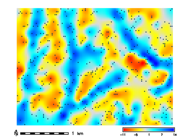

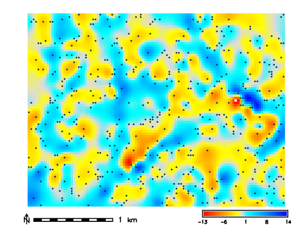

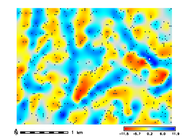

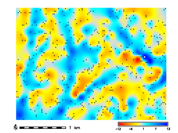

v.surf.rst.cv - Cross-validation of regularized spline with tension (RST)
surface model.
Predictive error of surface approximation for given parameters are
computed and a cross-validation procedure is then performed using the
data given in the vector map input. The estimated predictive errors are
stored in the optionally saved vector point map cvdev.
For larger data sets, CV should be applied to a representative subset of the
data. The cross-validation procedure works well only for well-sampled phenomena
and when minimizing the predictive error is the goal. The parameters found by
minimizing the predictive (CV) error may not not be the best for for poorly
sampled phenomena (result could be strongly smoothed with lost details and
fluctuations) or when significant noise is present that needs to be smoothed out.
v.surf.rst.cv point_cloud=lidar
