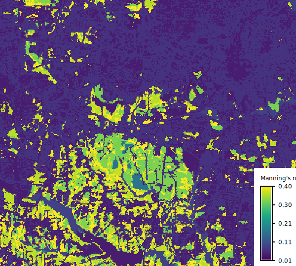

Map of Manning's n values
Figure: Manning's n values for 2024 NLCD using Kalyanapu et al.
