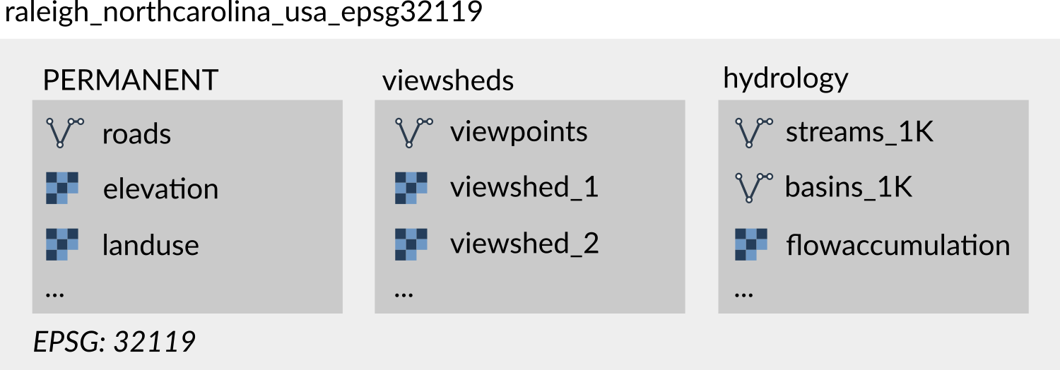

Multiple mapsets in a project
Figure: Project raleigh_northcarolina_usa_epsg32119 uses CRS with EPSG code 32119 and contains three mapsets: PERMANENT, viewsheds, and hydrology
A GRASS project is stored as a directory on disk. Many prefer to keep multiple projects organized in a single directory, commonly referred to as GRASS database and named grassdata. Others store them in separate directories organized according to their research projects. GRASS projects can be safely copied, moved, or compressed (zipped) for sharing or backup, making it easy to transfer an entire project to another location or collaborator.

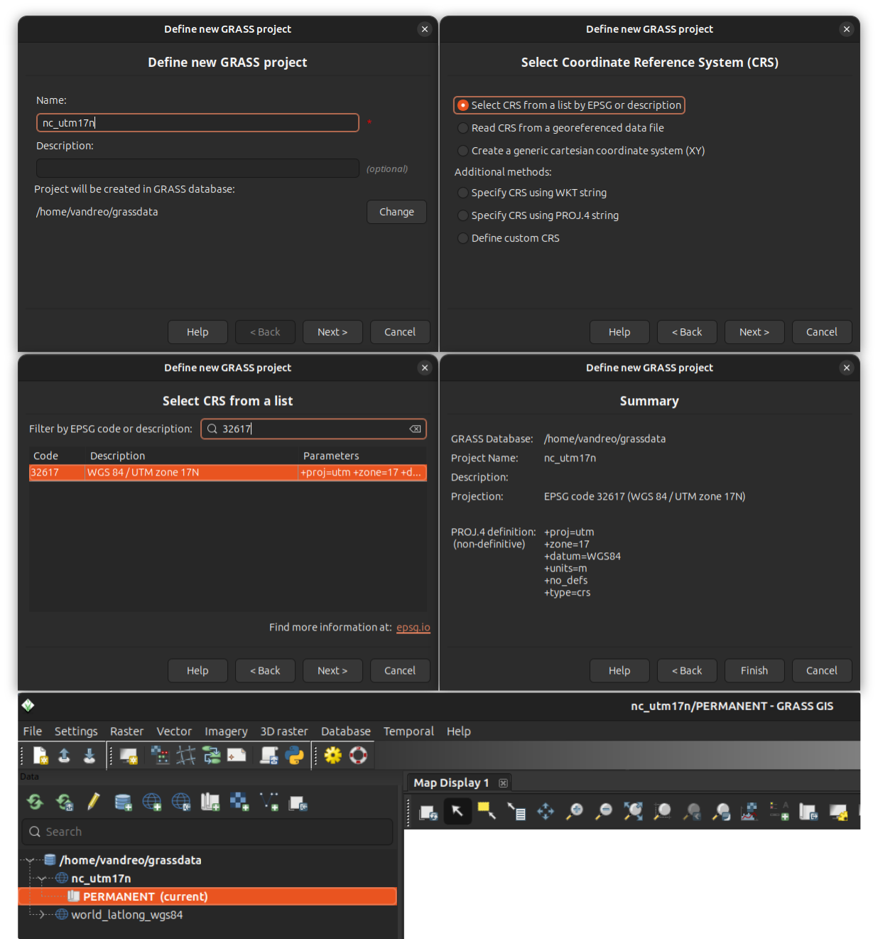

  • GRASS GUI Project Wizard: Guides you step-by-step to set the CRS and optionally import a georeferenced file.
    Project Wizard
