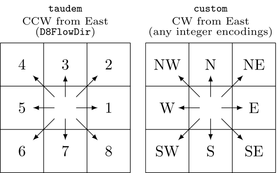

r.upflowlength can automatically recognize the following three different formats of flow directions: degree, 45degree, and power2. The degree format starts just above 0° at East (excluding 0° itself) and goes counterclockwise up to 360°, which also corresponds to East. The 45degree format divides the degree format by 45°. The power2 format starts from 1 at East and doubles clockwise up to Northeast.
Auto-detected flow direction formats
r.upflowlength also supports the taudem format, which is used by TauDEM's D8FlowDir. This format is not auto-detected because it shares the same encoding range of the 45degree format. Additionally, the module can accept any integer encodings with the custom format and encoding option, which uses eight numbers for E, SE, S, SW, W, NW, N, and NE. For example, to encode the 45degree format using this method, one can use format=custom encoding=8,7,6,5,4,3,2,1.
Custom flow direction formats

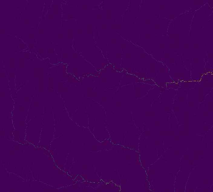

Extract all draining cells (all outlets for the elevation raster), and calculate all watersheds and longest flow paths:
# set computational region
g.region -ap rast=elevation
# calculate drainage directions using r.watershed
r.watershed -s elev=elevation drain=drain
# calculate upstream flow length
r.upflowlength input=drain output=uflen
# or using a custom format for r.watershed drainage (8-1 for E-NE CW)
r.upflowlength input=drain format=custom encoding=8,7,6,5,4,3,2,1 output=uflen2

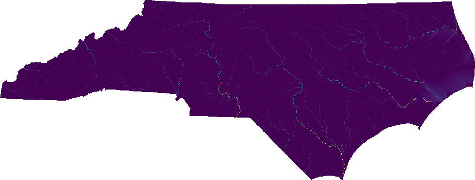

Perform the same analysis using the statewide DEM, elev_state_500m:
g.region -ap rast=elev_state_500m
r.watershed -s elev=elev_state_500m drain=nc_drain
r.upflowlength input=nc_drain output=nc_uflen
r.upflowlength input=nc_drain format=custom encoding=8,7,6,5,4,3,2,1 output=nc_uflen2
