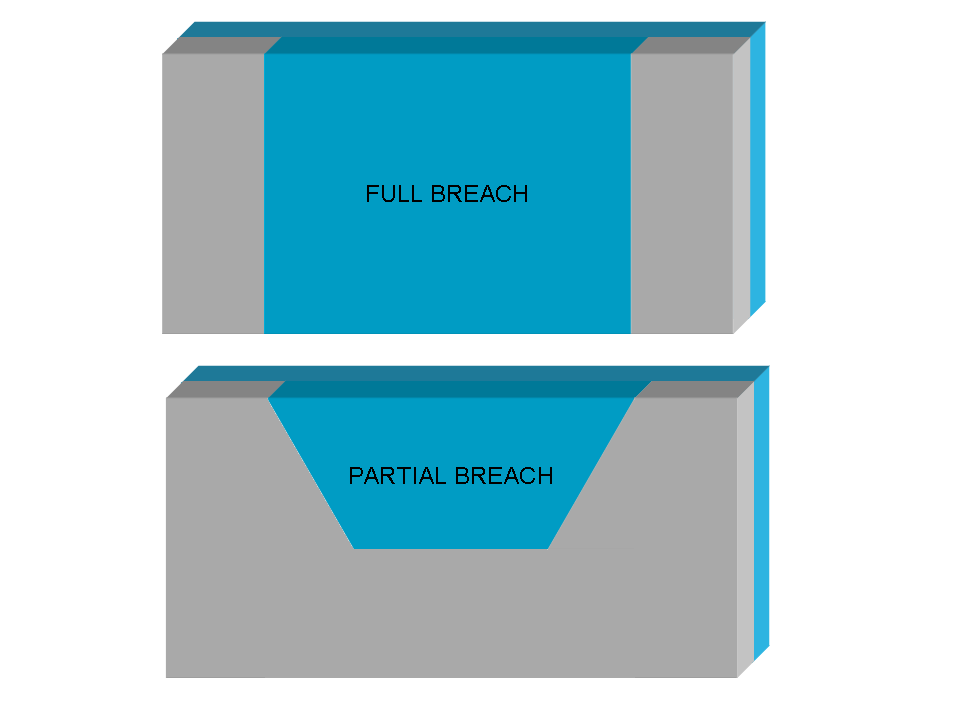

Actually two different dam failure type are considered by the command: (i) full breach, (ii) partial breach.
image-alt
In case of total istantaeous dam break (configuration i), the initial velocity is computed directly applying the SWE at the first time step; while in case of partial dam breach (configuration ii) the user can choose between don't use any hypothesis, like in the previous configuration, or evaluate the initial velocity using the overflow spillway equation:
V = 0.4 * sqrt(2 g h)
where V is the water flow velocity expressed in m/s, g is the gravitational acceleration expressed in m/s2 and h is the water depth in correspondence of the dam breach expresssed in meters (m).
