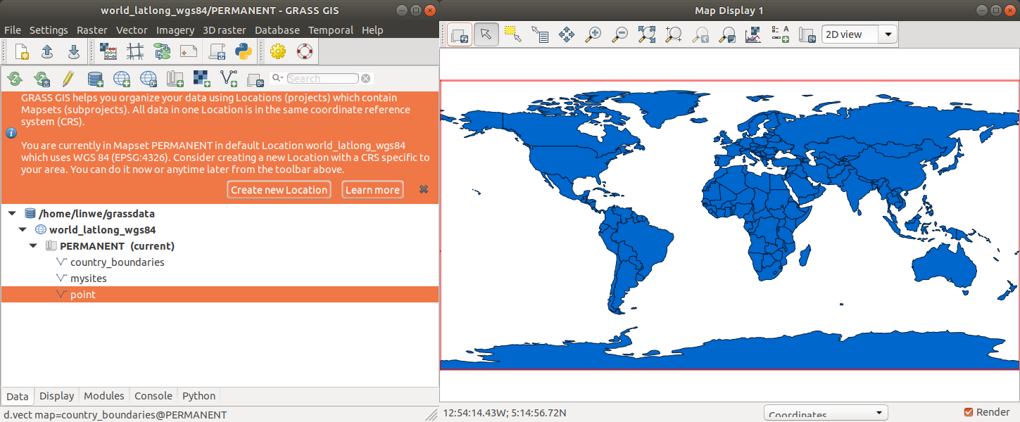

When launching GRASS for the first time, you will open a default project "world_latlog_wgs84" where you can find a map layer called "country_boundaries" showing a world map in the WGS84 coordinate system.
GRASS after first startup
The main component of the Data tab is the Data Catalog which shows the GRASS hierarchical structure consisting of database GRASS
Database, project project and mapset mapset.
GRASS Database GRASS database (directory with projects)
Running GRASS for the first time, a folder named "grassdata" is automatically created. Depending on your operating system, you can find it in your $HOME directory (*nix) or My Documents (MS Windows).
project project (previously called location)
A project is defined by its coordinate reference system (CRS). In the case of the default project, it is a geographic coordinate reference system WGS84 (EPSG:4326). If you have data in another CRS than WGS84, you should create a new project corresponding to your system.
mapset mapset (a subproject)
Each project can have many mapsets for managing different aspects of a project or project's subregions. When creating a new project, GRASS automatically creates a special mapset called PERMANENT where the core data for the project can be stored.
For more info about data hierarchy, see GRASS projects page.
