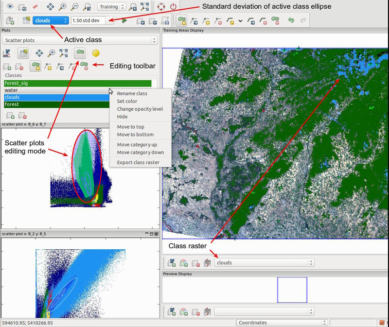

Interactive Scatter Plot Tool allows analyzing group of raster maps. The tool is integrated into Supervised Classification Tool (see the screen shot below). Also it is possible to launch it from Map Display Window (Analyze map → Interactive Scatter Plot Tool). The main idea of the tool is that everything is linked together (scatter plots together and mapwindow with the scatter plots). The main feature of the tool is the interactivity, which allows user to:
  • work with multiple plots, which represents multiple raster bands combinations,
  • highlight plotted points in open scatter plots according to currently chosen pixels for classes by it's training areas (supported only in Supervised Classification Tool),
  • be able to define areas in plots and the tool will highlight pixels in map display window and corresponding points in other plots,
  • plot of confidence ellipses.
TOOL CONTROLS LAYOUT
If editing mode is activated (the green polygon tool in toolbar), the areas which were selected in the scatter plots are highlighted. In the image you can see this area for scatter plot of bands B_6, B_7 inside the ellipse. Opacity and color of the selected area can be set in settings. The area corresponds to the active class (in this case clouds). Selected areas are subset of areas, which belongs to the category.
In the editing mode it is possible to select certain area by the polygon, which can be created and edited by tools in editing toolbar. After the area is selected, we can include or exclude it into active category by clicking on the first (plus) respectively second (minus) tool in the editing toolbar. In mapwindow corresponding pixels are shown by the class raster representing selected areas in scatter plots. In this case we can see clouds class raster (blue), forest class raster (green) and water class raster (red).
