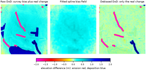

The commands below use the example scene built in the r.dem toolset manual, which is derived from the North Carolina sample dataset. Build it there first.
The scene carries three bias components, and each method removes a different one. Chain them: no single method removes all three.
Start with the long-wavelength dome, fitted from the stable cells and interpolated across the map:
g.region raster=elev_lid792_1m
r.dem.bias dod=dod_raw output=dod_spline method=spline \
    stable_mask=stable_terrain bias_field=bias_spline
Then the canopy bump, estimated as a local trimmed median under the forest mask:
r.dem.bias dod=dod_spline output=dod_debiased method=forest \
    mask=forest window=21
The residual on stable terrain falls from 0.17 m to under 0.01 m, and the residual over forest falls from 1.68 m to under 0.01 m.
