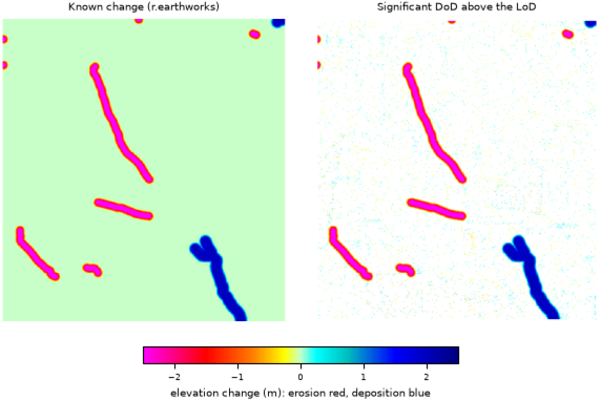

The volumes can be checked against the volumes r.earthworks moved when the scene was built; they land within a few percent.
The -n flag matters here. Without it, noise that clears the detection limit by chance is counted as change, and on this scene that inflates both volumes by roughly ten percent. Speckle removal drops isolated cells, which real erosion and deposition are not.

r.dem.change example
Figure: The known change added with r.earthworks, and the significant DoD recovered above the Level of Detection.
