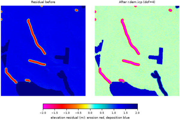

The commands below use the example scene built in the r.dem toolset manual, which is derived from the North Carolina sample dataset. Build it there first.
Align the misregistered surface with four degrees of freedom, which solves three translations and yaw:
g.region raster=elev_lid792_1m
r.dem.icp source=dsm_offset reference=elev_lid792_1m \
    mask=stable_terrain output=dsm_icp dof=4 \
    transform_out=icp_transform.txt stats_out=icp_stats.csv
The reported transform is the one that maps the source onto the reference, so its signs are opposite to those of r.dem.nk. Against an applied offset of 0.4596 m east, 0.4596 m north, and 1.32 m up it returns:
tx=-0.4590844708
ty=-0.4608043693
tz=-1.3201388046
yaw=0.0000935114
r.dem.icp example
Figure: Stable-terrain residual before and after r.dem.icp at dof=4.
