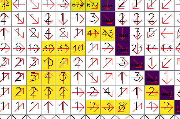

image-alt

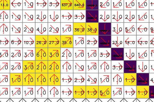

There are slight differences between the two output maps. The yellow and purple cells show the difference raster map (flow_accum_diff). The red arrows and numbers represent drainage directions (drain_directions) and flow accumulation by r.watershed (flow_accum), respectively. Note that some cells close to headwater cells are assigned 1 even though they are located downstream of other cells.
image-alt
For comparison, these numbers show the new flow accumulation by r.flowaccumulation (flow_accum_new). The same cells are properly accumulated from the headwater cells.
