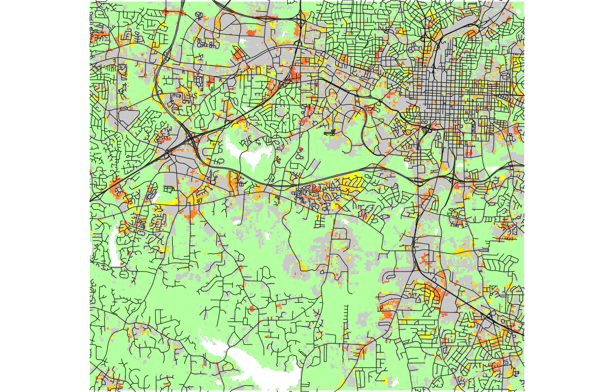

FUTURES example
Figure: One stochastic realization of FUTURES simulation, orange to yellow gradient represents new development where yellow is the latest.
