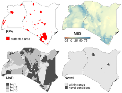

Example 2
In the second example, conditions in the whole region are compared to those in the region's protected areas (ppa), which thus serves as the reference/sample area. See van Breugel et al.(2015) [3] for an example of how this can be useful.
g.region raster=bio1
r.mess -m -n -i ref_env=bio1,bio12,bio15 ref_rast=ppa output=Ex_02
In the figure below the map with the protected areas, the MES, the most dissimilar variables, and the areas with novel conditions are given. They show that the protected areas cover most of the region's annual precipitation, mean annual temperature, and precipitation seasonality gradients. Areas with novel conditions can be found in northern Kenya.
image-alt

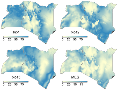

Example 3
Similarity between long-term average conditions based on the period 1950-2000 (ref_env) and projections for climate conditions in 2070 under RCP85 based on the IPSL General Circulation Models ( proj_env). No reference points or areas are defined in this example, so the whole region is used as a reference.
r.mess ref_env=bio1,bio12,bio15 proj_env=IPSL_bio1,IPSL_bio12,IPSL_bio15
output=Ex_03
Results (below) shows that there is a fairly large area with novel conditions. Note that in the MES map, the values are based on the highest negative value across the input variables (here bio1, bio12, bio15). In the SumNeg map, values of all input variables are summed when negative. The Count map shows for each raster cell how many variables have negative similarity scores. Thus, the values in the MES and SumNeg maps only differ where the MES of more than one variable is negative (dark gray areas in the Count map).
image-alt
