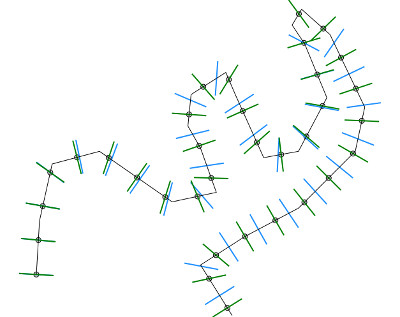

The following pictures show the effect of different options on a line with simple geometry. In the first picture, the circles show points generated by v.segment in 100 m interval along the line. The green lines were generated with option metric=along, therefore they match with the points. The blue lines were generated with metric=straight.
In the second picture, green lines use transect_perpendicular=line while the blue ones use transect_perpendicular=trend.
