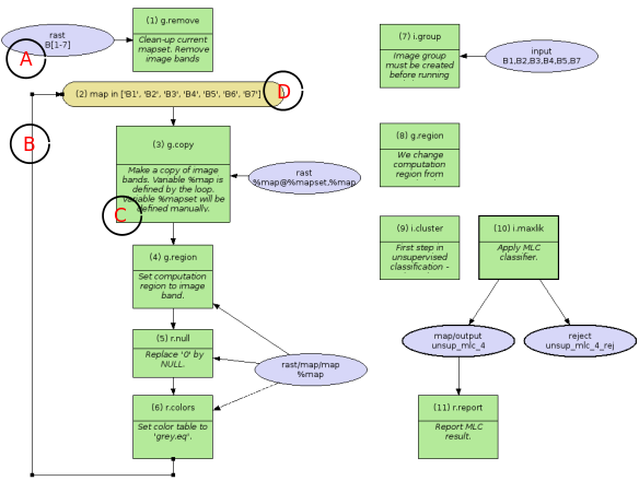

Components of models
The workflow is usually established from four types of diagrams. Input and derived model data are usually represented with oval diagrams. This type of model elements stores path to specific data on the user's disk. It is possible to insert vector data, raster data, database tables, etc. The type of data is clearly distinguishable in the model by its color. Different model elements are shown in the figures below.
  • \(A\) raster data: raster
  • \(B\) relation: relation
  • \(C\) GRASS module: module
  • \(D\) loop: loop
  • \(E\) database table: db
  • \(F\) 3D raster data: raster3D
  • \(G\) vector data: vector
  • \(H\) disabled GRASS module: modulex
  • \(I\) comment: comment
A model to perform unsupervised classification using MLC
Figure: A model to perform unsupervised classification using MLC (i.maxlik) and SMAP (i.smap).

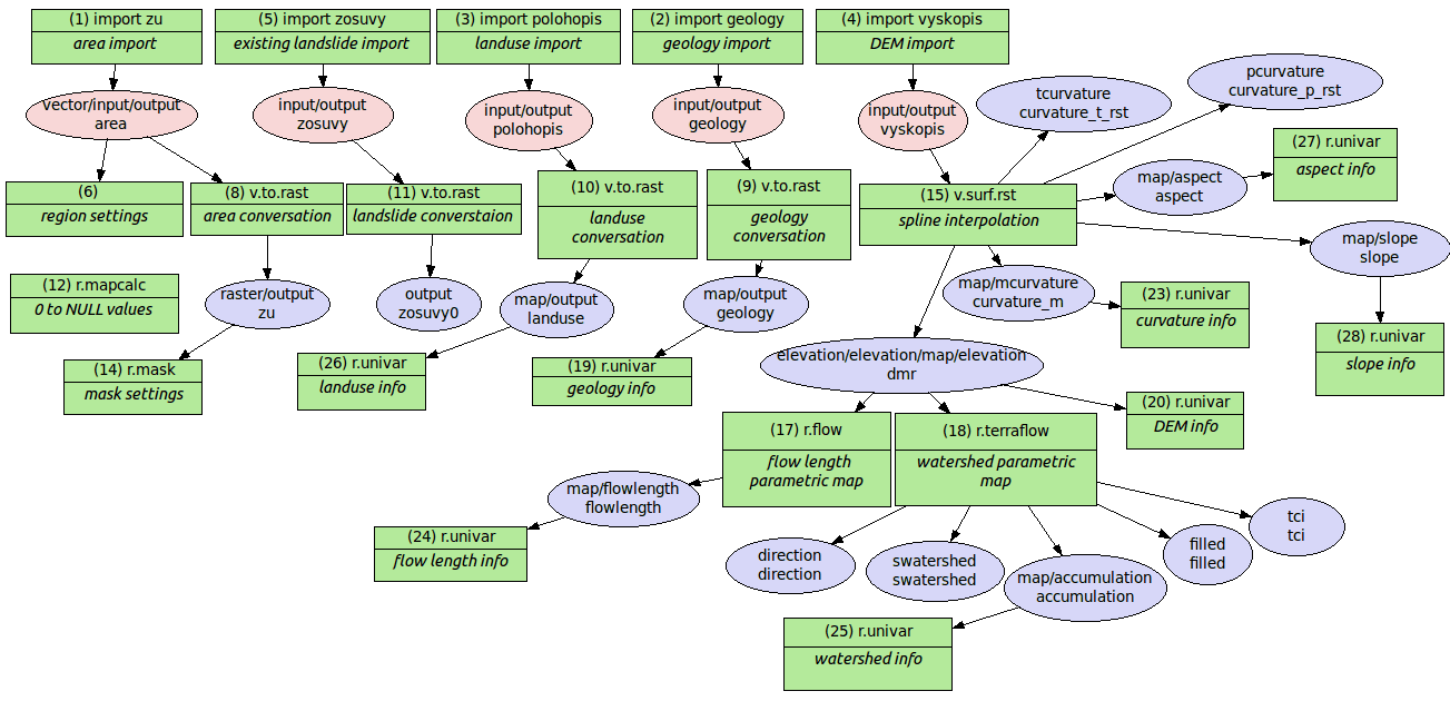

Example as part of landslide prediction process:
A model to create parametric maps
Figure: A model to create parametric maps used by geologists to predict landslides in the area of interest.

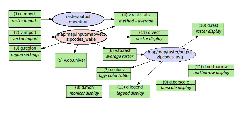

EXAMPLE
In this example the zipcodes_wake vector data and the elev_state_500m raster data from the North Carolina sample dataset (original raster and vector data) are used to calculate average elevation for every zone. The important part of the process is the Graphical Modeler, namely its possibilities of process automation.
The workflow shown as a series of commands
In the command console the procedure looks as follows:
# input data import
r.import input=elev_state_500m.tif output=elevation
v.import input=zipcodes_wake.shp output=zipcodes_wake
# computation region settings
g.region vector=zipcodes_wake
# raster statistics (average values), upload to vector map table calculation
v.rast.stats -c map=zipcodes_wake raster=elevation column_prefix=rst method=average
# univariate statistics on selected table column for zipcode map calculation
v.db.univar map=zipcodes_wake column=rst_average
# conversion from vector to raster layer (due to result presentation)
v.to.rast input=zipcodes_wake output=zipcodes_avg use=attr attribute_column=rst_average
# display settings
r.colors -e map=zipcodes_avg color=bgyr
d.mon start=wx0 bgcolor=white
d.barscale style=arrow_ends color=black bgcolor=white fontsize=10
d.rast map=zipcodes_avg bgcolor=white
d.vect map=zipcodes_wake type=boundary color=black
d.northarrow style=1a at=85.0,15.0 color=black fill_color=black width=0 fontsize=10
d.legend raster=zipcodes_avg lines=50 thin=5 labelnum=5 color=black fontsize=10
Defining the workflow in the Graphical Modeler

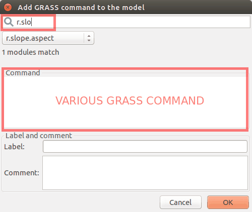

To start performing above steps as an automatic process with the Graphical Modeler press the icon icon or type g.gui.gmodeler. The simplest way of inserting elements is by adding the complete GRASS command to the Command field in the GRASS command dialog (see figure below). With full text search one can do faster module hunting. Next, the label and the command can be added. In case that only a module name is inserted, after pressing the Enter button, the module dialog window is displayed and it is possible to set all of the usual module options (parameters and flags).
Dialog for adding GRASS commands to model
Figure: Dialog for adding GRASS commands to model.

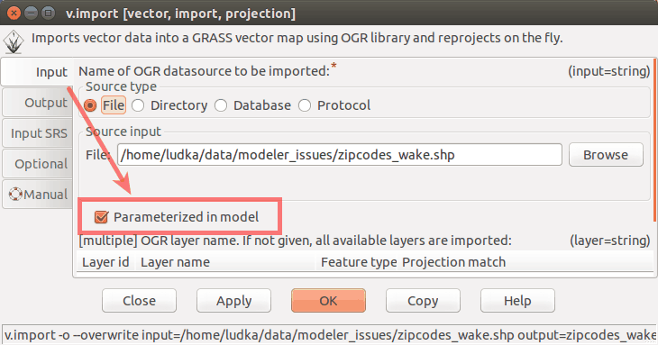

All used modules can be parameterized in the model. That causes launching the dialog with input options for model after the model is run. In this example, input layers (zipcodes_wake vector map and elev_state_500m raster map) are parameterized. Parameterized elements show their diagram border slightly thicker than those of unparameterized elements.
Model parameter settings
Figure: Model parameter settings.
The final model, the list of all model items, and the Script editor window with Save and Run option are shown in the figures below.
A model to perform average statistics for zipcode zones
Figure: A model to perform average statistics for zipcode zones.

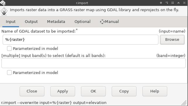

Another useful trick is the possibility to set variables. Their content can be used as a substitute for other items. Value of variables can be values such as raster or vector data, integer, float, string value or they may constitute some region, mapset, file or direction data type. Then it is not necessary to set any parameters for input data. The dialog with variable settings is automatically displayed after the model is run. So, instead of model parameters (e.g. r.import a v.import, see the Figure Run model dialog above) there are Variables.
Model with variable inputs
Figure: Model with variable inputs.

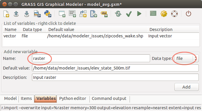

The key point is enclosing the substituting variable into %{...} and setting the value in the Variables dialog. For example, in the case of a model variable raster that points to an input file path and which value is required to be used as one of inputs for a particular model, it should be specified in the Variables dialog with its respective name (raster), data type, default value and description. Then it should be set in the module dialog as input called %{raster}.
Example of raster file variable settings
Figure: Example of raster file variable settings.

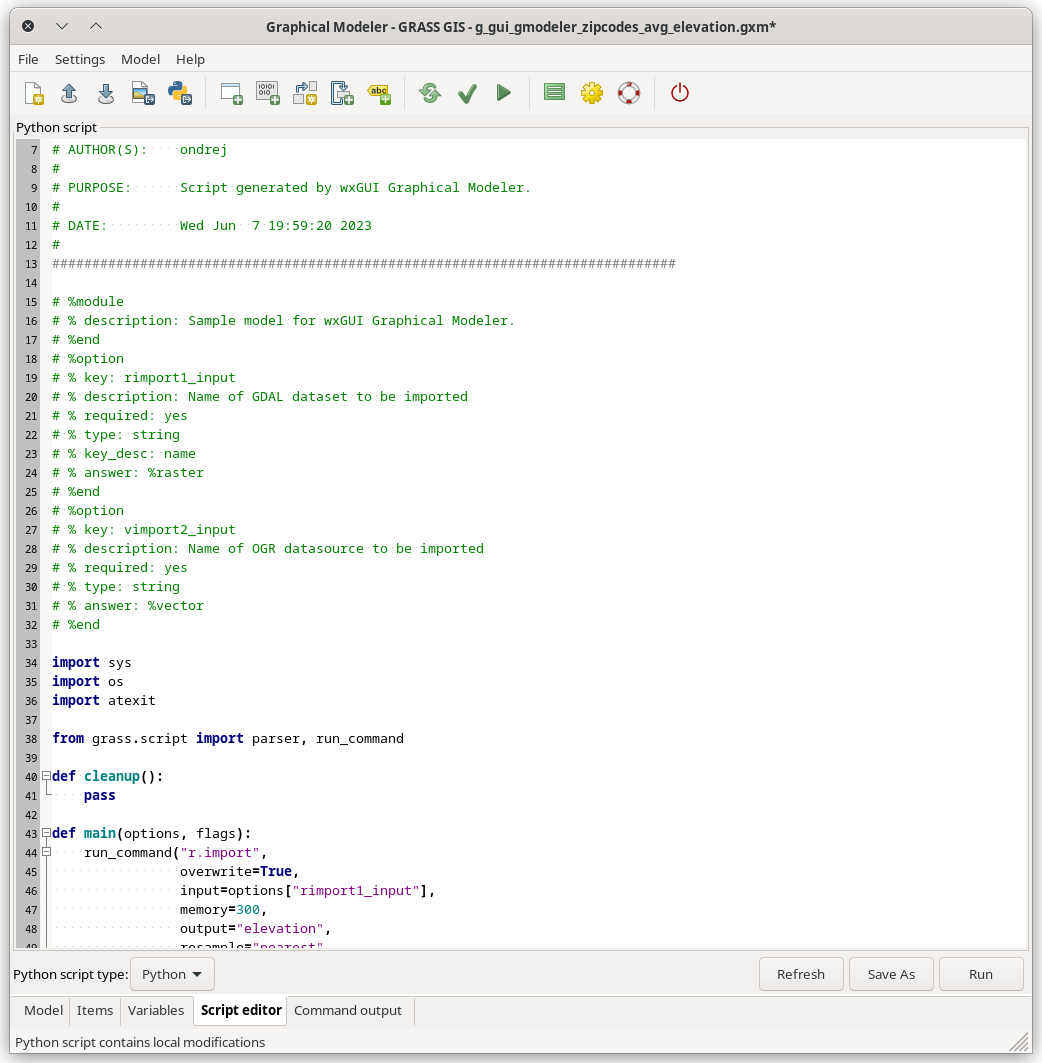

Using the Script editor
By using the Script editor in the Graphical Modeler, the user can add Python code and then run it with Run button or just save it as a Python script *.py. The result is shown in the Figure below:
Script editor in the wxGUI Graphical Modeler: code Script editor in the wxGUI Graphical Modeler: result
Figure: Script editor in the wxGUI Graphical Modeler.

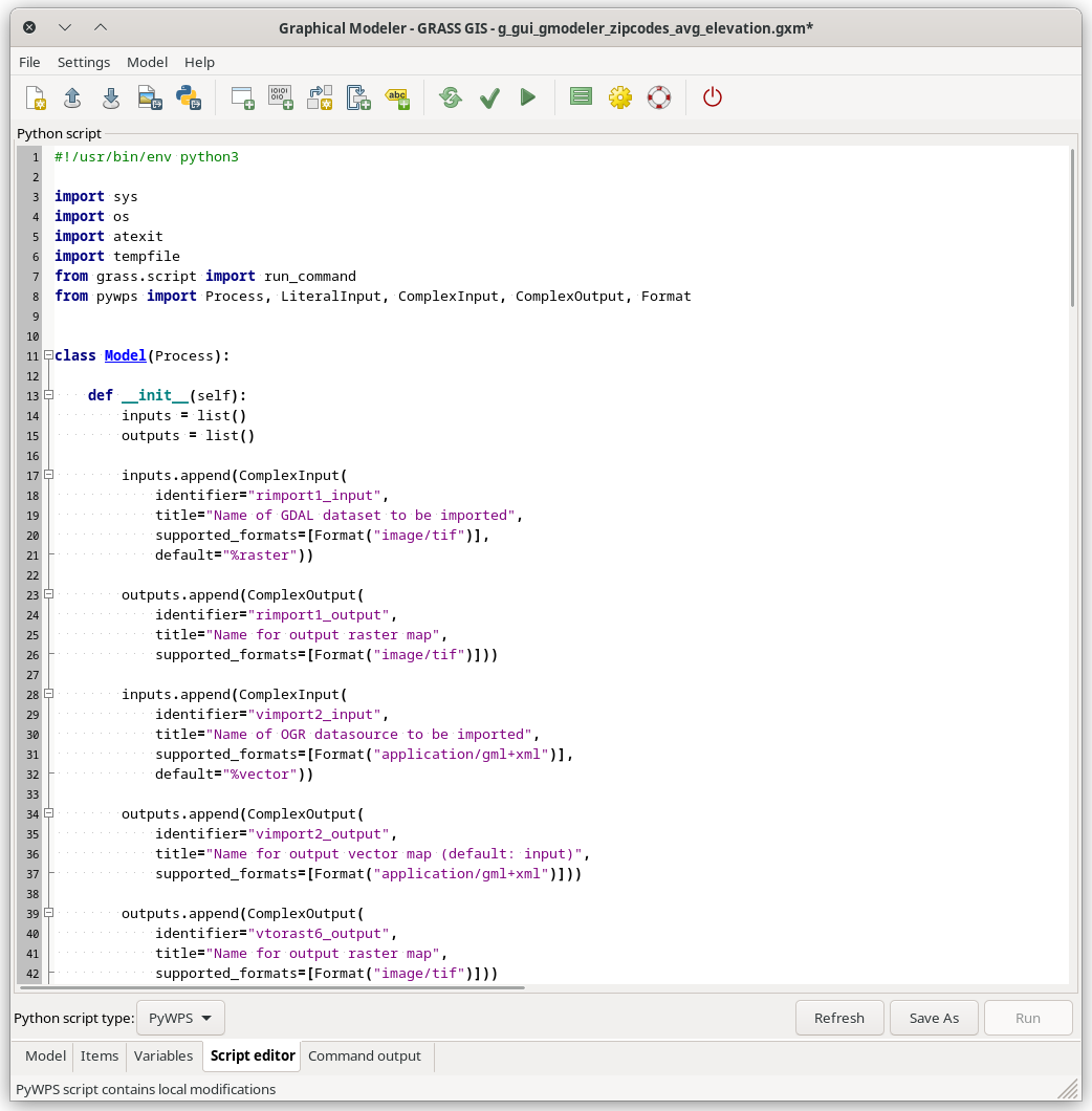

The second option in the Script type combobox exports a PyWPS script instead of a basic Python one. A PyWPS process based on the model will be generated then; for the PyWPS script, the Run button is disabled as users are expected to include this script in their web processing service and not to run it on itself.
Script editor in the wxGUI Graphical Modeler - set to PyWPS
Figure: Script editor in the wxGUI Graphical Modeler - set to PyWPS.

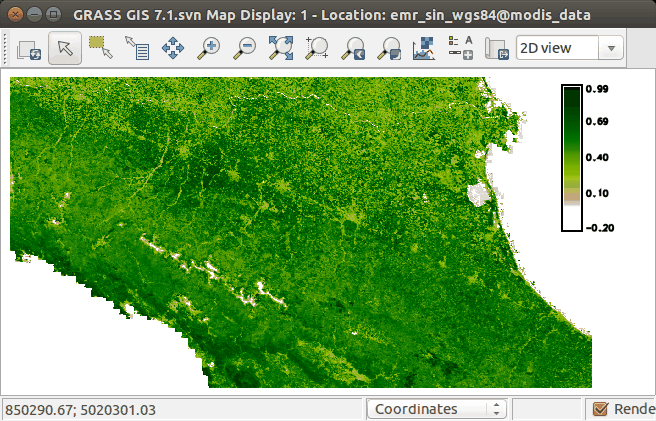

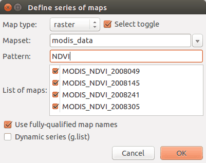

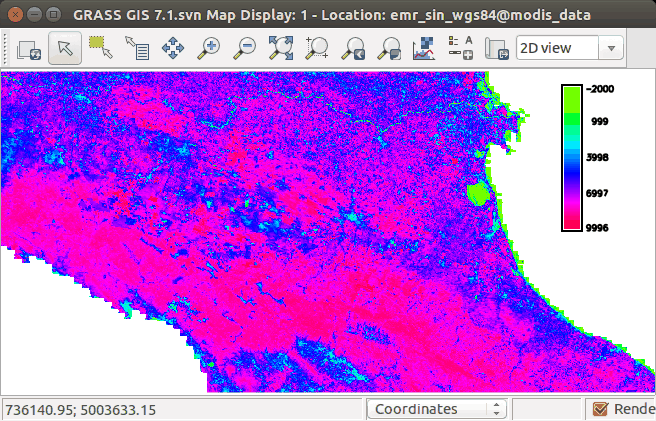

In the example below the MODIS MOD13Q1 (NDVI) satellite data products are used in a loop. The original data are stored as coded integer values that need to be multiplied by the value 0.0001 to represent real ndvi values. Moreover, GRASS provides a predefined color table called ndvi to represent ndvi data. In this case it is not necessary to work with every image separately.
The Graphical Modeler is an appropriate tool to process data in an effective way using loop and variables (%{map} for a particular MODIS image in mapset and %{ndvi} for original data name suffix). After the loop component is added to model, it is necessary to define series of maps with required settings of map type, mapset, etc.
MODIS data representation in GRASS after Graphical Modeler
usage
Figure: MODIS data representation in GRASS after Graphical Modeler usage.
When the model is supplemented by all of modules, these modules should be ticked in the boxes of loop dialog. The final model and its results are shown below.
