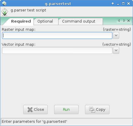

All examples below autogenerate the graphical user interface when invoked without parameters of flags:
Autogenerated GUI window
To run properly, the script needs to be copied into a directory listed in $GRASS_ADDON_PATH environmental variable with the executable flag being set.
The script will provide a GUI (as above) and the following usage help text:
