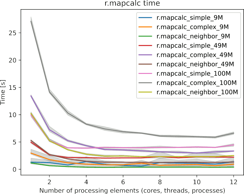

nprocs=integer
    Default: 0

Performance
r.mapcalc is parallelized using OpenMP. The number of threads can be controlled with the nprocs parameter. Note that more complex expressions can benefit from more threads. By default (nprocs=0), r.mapcalc uses all available threads. Use the --verbose flag to display the number of threads in use. If you observe reduced performance when using many threads, try lowering the number.
Note: r.mapcalc may disable parallelization in certain cases, even when requested:
  • When a mask is active, because the current parallel implementation does not support it.
Benchmark of r.mapcalc
Figure: Benchmark shows execution time for different number of cells and different complexity of expressions. See benchmark script in the source code. (Intel Core i9-10940X CPU @ 3.30GHz x 28)
