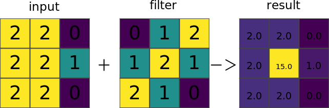

r.mfilter filters the raster input to produce the raster output according to the matrix filter designed by the user (see FILTERS below).
Illustration for a custom 3x3 filter
Figure: Illustration for a custom 3x3 filter

HOW THE FILTER WORKS
The filter process produces a new category value for each cell in the input raster map layer by multiplying the category values of the cells in the n x n neighborhood around the center cell by the corresponding matrix value and adding them together. If a divisor is specified, the sum is divided by this divisor. (If a zero divisor was specified, then the divisor is computed for each cell as the sum of the MATRIX values where the corresponding input cell is non-null.)
If more than one filter step is specified, either because the repeat value was greater than one or because the filter file contained more than one matrix, these steps are performed sequentially. This means that first one filter is applied to the entire input raster map layer to produce an intermediate result; then the next filter is applied to the intermediate result to produce another intermediate result; and so on, until the final filter is applied. Then the output cell is written.

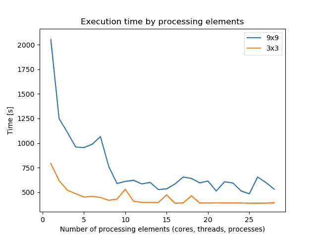

PERFORMANCE
By specifying the number of parallel processes with nprocs option, r.mfilter can run significantly faster, see benchmarks below.
benchmark for number of cells benchmark for window size
Figure: Benchmark on the left shows execution time for different number of cells for 9x9 matrix, benchmark on the right shows execution time for 16 billion cells for different matrix sizes. (Intel Core i9-10940X CPU @ 3.30GHz x 28)
Note that parallelization is implemented only for the parallel filter, not the sequential one. To take advantage of the parallelization, GRASS needs to compiled with OpenMP enabled.
