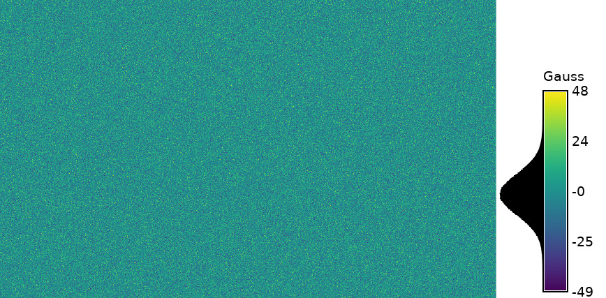

g.region -p n=228500 s=215000 w=630000 e=645000 res=10
r.surf.gauss out=gauss mean=0 sigma=10
# check result
r.univar gauss
r.surf.gauss example (mean: 0; sigma: 10)
Figure: Random Gaussian surface example (mean: 0; sigma: 10)

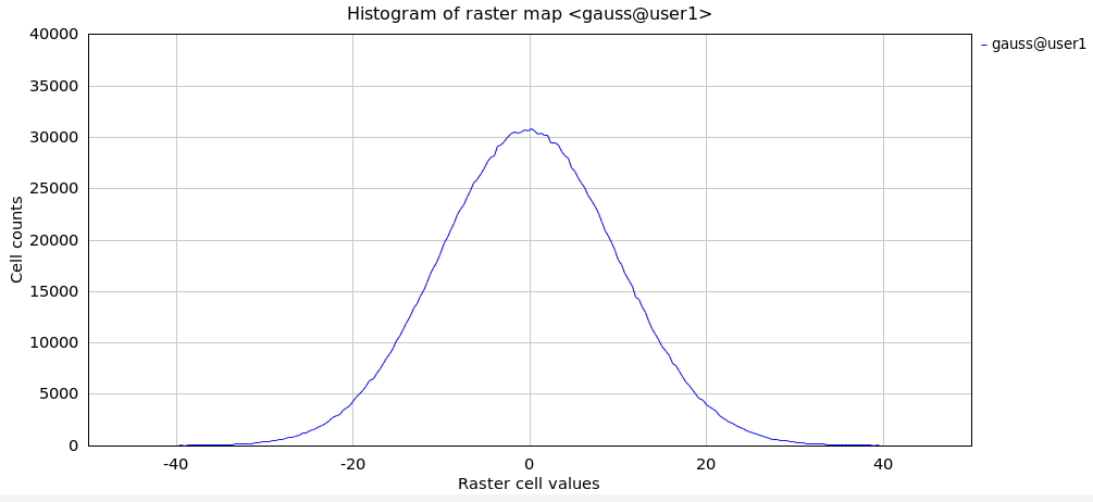

With the histogram tool the cell values versus count can be shown.
r.surf.gauss example histogram (mean: 0; sigma: 10)
Figure: Histogram of random Gaussian surface example (mean: 0; sigma: 10)
