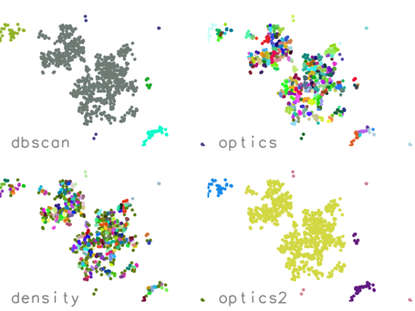

Four different methods with default settings applied to 1000
random points
Figure: Four different methods with default settings applied to 1000 random points generated in the same way as in the example.
