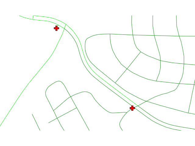

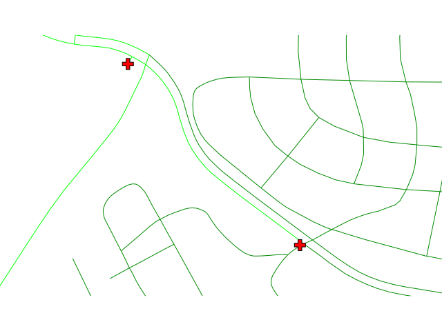

The nearest center can be determined using either costs from the nearest center or costs to the nearest center with option method. See example below.

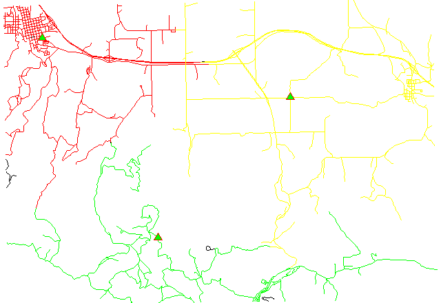

Example 1: Calculating subnets for 3 center nodes using distances
# Spearfish
# center nodes:
echo "591235.5|4926306.62|1
596591.8|4917042.5|2
602722.9|4923544.2|3" | v.in.ascii in=- out=centernodes
g.copy vect=roads,myroads
# connect points to network
v.net myroads points=centernodes out=myroads_net op=connect thresh=200
# allocate, specifying range of center cats (easier to catch all):
v.net.alloc myroads_net out=myroads_net_alloc center_cats=1-100000 node_layer=2
# report categories
v.category myroads_net_alloc option=report
To display the result, run for example:
# show result
g.region vector=myroads_net
d.mon x0
d.vect myroads_net layer=1
# the result has to be selected by category number of the relevant node:
d.vect myroads_net_alloc cat=1 col=red layer=1
d.vect myroads_net_alloc cat=2 col=green layer=1
d.vect myroads_net_alloc cat=3 col=yellow layer=1
# center nodes
d.vect myroads_net col=red icon=basic/triangle fcol=green size=12 layer=2

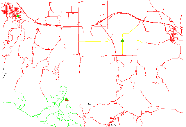

Example 2: Calculating subnets for 3 center nodes using traveling time
# Spearfish
# center nodes:
# create lines map connecting points to network
v.net myroads points=centernodes out=myroads_net op=connect thresh=500 arc_layer=1 node_layer=2
# set up costs
# create unique categories for each road in layer 3
v.category in=myroads_net out=myroads_net_time opt=add cat=1 layer=3 type=line
# add new table for layer 3
v.db.addtable myroads_net_time layer=3 col="cat integer,label varchar(43),length double precision,speed double precision,cost double precision,bcost double precision"
# copy road type to layer 3
v.to.db myroads_net_time layer=3 qlayer=1 opt=query qcolumn=label columns=label
# upload road length in miles
v.to.db myroads_net_time layer=3 type=line option=length col=length unit=miles
# set speed limits in miles / hour
v.db.update myroads_net_time layer=3 col=speed val="5.0"
v.db.update myroads_net_time layer=3 col=speed val="75.0" where="label='interstate'"
v.db.update myroads_net_time layer=3 col=speed val="75.0" where="label='primary highway, hard surface'"
v.db.update myroads_net_time layer=3 col=speed val="50.0" where="label='secondary highway, hard surface'"
v.db.update myroads_net_time layer=3 col=speed val="25.0" where="label='light-duty road, improved surface'"
v.db.update myroads_net_time layer=3 col=speed val="5.0" where="label='unimproved road'"
# define traveling costs as traveling time in minutes:
# set forward costs
v.db.update myroads_net_time layer=3 col=cost val="length / speed * 60"
# set backward costs
v.db.update myroads_net_time layer=3 col=bcost val="length / speed * 60"
# subnetwork allocation with fastest paths
v.net.alloc in=myroads_net_time arc_layer=3 node_layer=2 arc_column=cost arc_backward_column=bcost out=myroads_net_alloc_time center_cats=1-3
# show result
d.mon x0
d.vect myroads_net type=line layer=1
d.vect myroads_net_alloc_time cat=1 col=red layer=1
d.vect myroads_net_alloc_time cat=2 col=green layer=1
d.vect myroads_net_alloc_time cat=3 col=yellow layer=1
# center nodes
d.vect myroads_net_time col=red icon=basic/triangle fcol=green size=12 type=point layer=2
Example 3: Differences between costs from centers and costs to
centers
Each lane of the two-lane road is a one-way road.
1. Subnetwork allocation from centers:
A center reaches any point following the one-way lanes.
2. Subnetwork allocation to centers:
Any node reaches reaches the nearest center following the one-way lanes.
