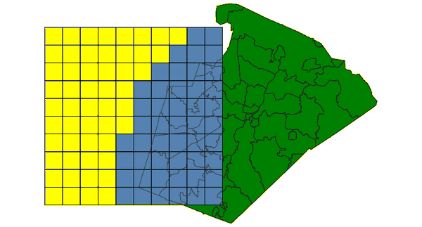

OVERLAP: features partially or completely overlap (using GRASS)
Select grid boxes (North Carolina sample dataset):
d.vect map=zipcodes_wake fill_color=0:128:0
d.vect map=boxgrid fill_color=85:130:176
v.select ainput=boxgrid binput=zipcodes_wake output=v_select_OVERLAP operator=overlap
d.vect map=v_select_OVERLAP
d.vect map=zipcodes_wake type=boundary color=255:255:50
v.select with OVERLAP operator: selected grid boxes shown in yellow
(using GRASS method)

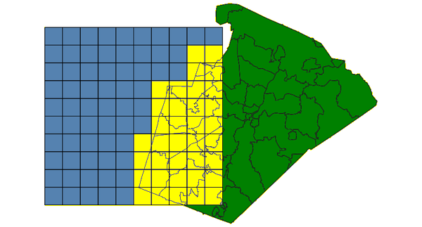

OVERLAPS features spatially overlap (using GEOS)
v.select ainput=boxgrid binput=zipcodes_wake output=v_select_OVERLAPS operator=overlaps
d.vect map=v_select_OVERLAPS
v.select with OVERLAPS operator: selected grid boxes shown in yellow
(using GEOS method)

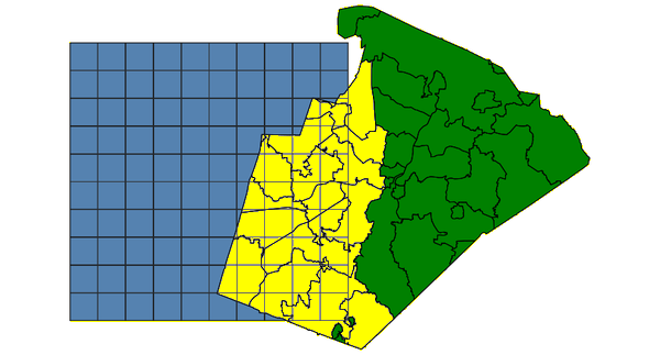

DISJOINT: features do not spatially intersect (using GEOS)
v.select ainput=boxgrid binput=zipcodes_wake output=v_select_DISJOINT operator=disjoint
d.vect map=v_select_DISJOINT
v.select with DISJOINT operator: selected grid boxes shown in yellow

v.select ainput=zipcodes_wake binput=zipcodeID35 output=v_select_EQUALS operator=equals
d.vect map=v_select_EQUALS
v.select with EQUALS operator: selected grid boxes shown in yellow
INTERSECTS: features spatially intersect (using GEOS)
Select zipcode polygons (North Carolina sample dataset):
v.select ainput=zipcodes_wake binput=boxgrid output=v_select_INTERSECTS operator=intersects
d.vect map=v_select_INTERSECTS
d.vect map=boxgrid type=boundary color=255:255:50
v.select with INTERSECTS operator: selected grid boxes shown in yellow

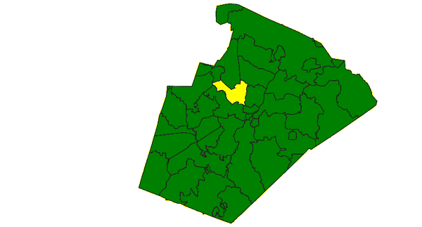

TOUCHES: features spatially touches (using GEOS)
Select polygons (North Carolina sample dataset):
d.vect map=zipcodeID35 fill_color=85:130:176
v.select ainput=zipcodes_wake binput=zipcodeID35 output=v_select_TOUCHES operator=touches
d.vect map=v_select_TOUCHES
v.select with TOUCHES operator: selected polygons shown in yellow (blue:
input polygon)

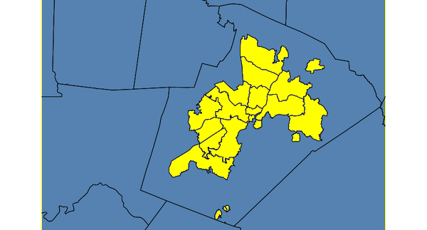

WITHIN feature A is completely inside feature B (using GEOS)
d.vect map=boundary_county fill_color=85:130:176
v.select ainput=zipcodes_wake binput=boundary_county output=v_select_WITHIN operator=within
d.vect map=v_select_WITHIN
v.select with WITHIN operator: selected polygons shown in yellow (blue:
input polygons)

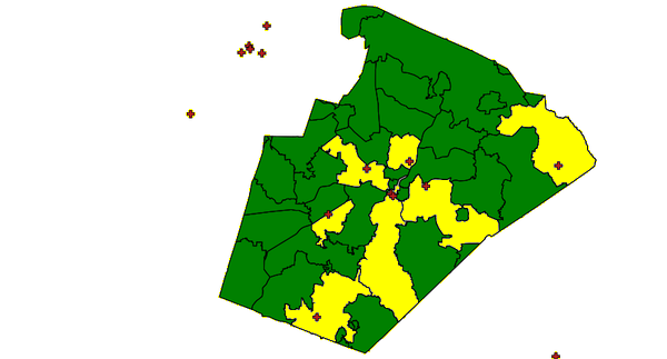

CONTAINS with points
d.vect map=hospitals fill_color=195:31:31 icon=basic/cross3 size=10
v.select ainput=zipcodes_wake binput=hospitals \
output=v_select_CONTAINS_pnts operator=contains
d.vect map=v_select_CONTAINS_pnts
v.select with CONTAINS operator: selected polygons shown in yellow (red:
input points)
