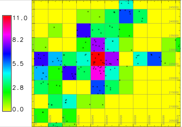

Convert vector points to raster with raster cell binning
In this example, the number of schools per raster cell are counted (North Carolina sample dataset):
g.copy vector=schools_wake,myschools_wake
# set computation region for raster binning
g.region vector=myschools_wake res=5000 -p -a
# add new column for counting
v.db.addcolumn myschools_wake column="value integer"
v.db.update myschools_wake column=value value=1
# verify attributes
v.db.select myschools_wake column=cat,value
v.out.ascii input=myschools_wake output=- column=value
# export and import on the fly, use 4th column (value) as input
v.out.ascii input=myschools_wake output=- column=value | r.in.xyz input=- \
            z=4 output=schools_wake_aggreg method=sum
d.mon wx0
d.rast schools_wake_aggreg
d.vect schools_wake
d.grid 5000
Number of schools per raster cell
